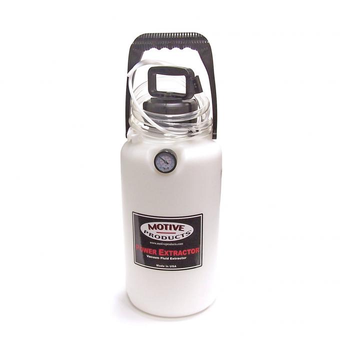

    I have a 2017 Nautique Super Air GS22 with and PCM zr4 engine. I just purchased the boat last year and am now doing the first oil change on the boat. I know ill sound dumb but i found the drain hose under the engine. But how exactly do i drain the oil? i cant find a valve or anything to start the flow. also where is the drain under the boat???
  • GMLIII
    • May 2013
    • 2821
    Purchase an oil extractor and run its drain tube up into the drain hose you are describing above. One of the most useful purchases you will ever make for boat maintenance.

          Ok I have the tube hooked to a fluid extractor but still nothing came out. I am not real sure on this. somthing dont seem right
