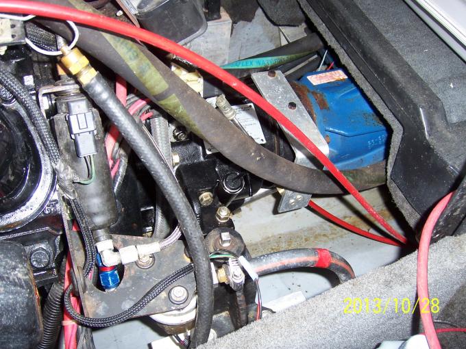

        The transmission dipstick isn’t as obvious on a GT40 as the engine and v-drive dipsticks. Engine is easy. V-drive is under the access panel under the rear seats right on top near the front end of the drive. The transmission dipstick is kind of down low on the passenger side on the transmission between the engine and v-drive. It’s usually yellow. I don’t still have a GT40 or I’d send you a pic.

          Here is a pic of my 95's. The trans dipstick is right in the center of this picture it's painted black
