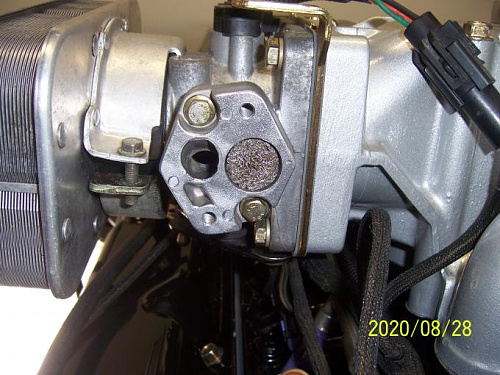

                Surging at idle could be the idle control valve, it's "screen" could be dirty or the idle control valve is sticking. First thing I'd do is clean the screen with carb cleaner. Here is where it is-

                          It's the air by-pass valve. Rather than opening the throttle plates like on a carbureted engine the computer opens or closes the air valve to adjust engine speed. Remove those 2 screws remove the valve and that "filter" screen is under there. Clean it and check to make sure the piston in that valve does not stick.

                            I had the same "hunting idle" condition on my 2002 PCM GT40. Idle would fluxuate between 600-950 rpm. I removed the air bypass valve and cleaned it with carb cleaner, followed by isopropyl alcohol, the seals may be effected by harsh solvents. Cleaned the mesh filter with solvent and reinstalled the valve. Issued was solved, I'm no expert, just my results.
