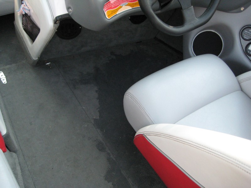

    A buddy of mine has a 2002 Team Edition, recently there has been extremely hot water on the floor in front of the drivers seat. So hot we have had to move off of it. CC Dealer resolved the problem by disconnecting the Shower completely which also made the Heater not work.. anyone heard of this, or want to take a stab at a fix. Evedentaly there is a hose leaking for the shower but rather than ficing it they just turned it off....

    There is a hose loop for the heater that taps into the block. It may also be where the shower taps as well. My 2002 does not have a shower, but I know the heater hoses are that orange hose color.
    Sounds to me like your heater core is cracked. Hot water at the drivers feet is either the hose connections failed or the core is cracked. Remove the kick panel and take a look. If the hoses are connected and are fine, then your core is shot. Call heatercraft and get a replacement. Or you can try to track one down at an autoparts store for less coin.

      Yep, sounds like a cracked heater core almost for sure. The heater core is under the dash (behind the kick panel), and when they crack, they leak hot water all over the driver's floor.

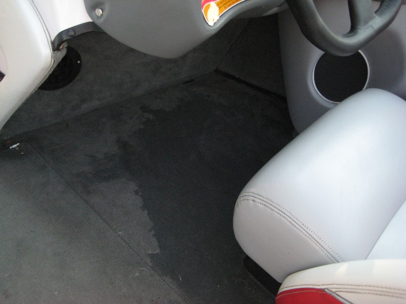

            This is now happening to my boat. There's no way my boat froze, so I'm at a bit of a loss. The hot water and the red hoses under the floor, and toward the top-right of the belly cargo area are very hot. I am really wondering if I can get away with using the boat for the rest of the summer with it like this. My boat is a 2001 Super Air, and I do have a heater.
            Any thoughts?

              I have the same boat, live in California, and I've lost a heater core. I think it quite possible the core froze and cracked.
              Yes, you can run it for the rest of the season no problem. I ran for a whole summer. You need to track down where the leak is. In my case, the leak was in the heater core, so I merely disconnected the two hoses from the core, used a short piece of pipe and two hose clamps and connected the hose ends together so the water would just loop through the hose and bypass the heater core. My core happens to be mounted under one of the bow seats so I didn't need to remove the kick panel to get to it. BKH
