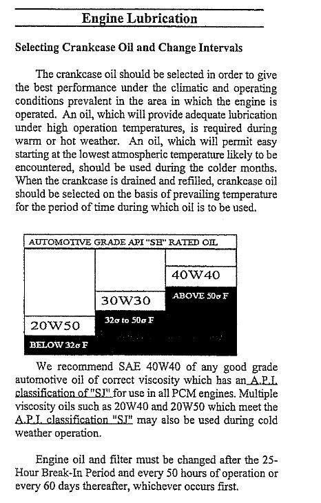

    High zinc oil is typically used for stressed engines to mitigate wear...ie / racing engines. Unless you're doing something unique with your engine I don't think you need it but it can't hurt (except in the pocketbook). Amsoil is generally considered a quality oil so no issues if you want to continue with that. Personally, I don't see normal GT-40 use stressing oils that much - RPMs rarely get over 3500 RPM, temps are contained, the environment is free of dirt, and you benefit from a modern ignition and fueling system. IMO, most important is the correct viscosity for your location and temps so you benefit good lubrication at startup. And...like everyone says....change it at 50 hours or so. I doubt most people follow the 60 day recommendation...i know I don't.
    This is a snip from the factory manual on oil selection.
