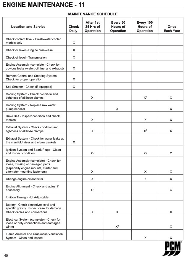

I bought my correct 2003 196SE craft this season and it will be 1200 hours old. In order to prepare for next season, what could I be advised to check or even change with these times. How many hours can a correct craft take?
request maintenance advice at 1200 hours
I bought my correct 2003 196SE craft this season and it will be 1200 hours old. In order to prepare for next season, what could I be advised to check or even change with these times. How many hours can a correct craft take?Tags: None
1,200 hours is nothing. I have owned Nautiques with over 2,000 hours that were still going strong.Please do not PM me directly asking for advice on how to repair your boat. While I would love to help everyone, I simply do not have time to respond to all of the inquiries. Please post your questions on the forum, so that all of our members have a chance to answer.
Eh, mine will be fine. PCM is going to go through the engine for me, just in case.Please do not PM me directly asking for advice on how to repair your boat. While I would love to help everyone, I simply do not have time to respond to all of the inquiries. Please post your questions on the forum, so that all of our members have a chance to answer.

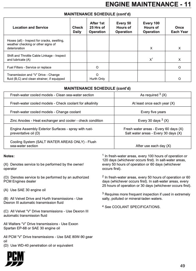

1200 hours? Regular maintenance. Nothing to do there aside from the normal:
Plugs, cap&rotor, trans fluid, impeller, fuel filter, oil change. That's about all that's required.
Inspect belts and hoses, replace as necessary. Maybe a set of plug wires.
