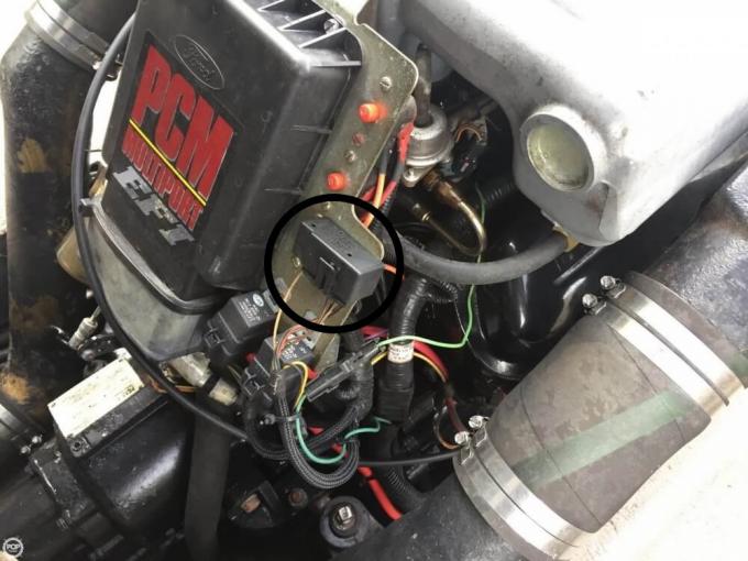

    Hello, I have a 2000 Ski Nautique with a GT40, because these boats had the Teleflex gauges and the hours were stored in the gauges and on my boat they had not been replaced the only proof I could find on hours so far is in the Perfect Pass, which I understand can be reset.
    I am trying to find out where my engine connector is on the GT 40, because I know that if connected by my tech he can see all the information about the engine to date, we cannot locate this connector, I looked at the schematics and it appears there should be a 6 pin connector but we cannot find any open 6pin connector only a 2 pin connector.
    Does anyone know where it is on the engine?
    Thank you

    What your calling the 6 pin connector is known as the STO connector even though there are only 4 wires in it. Won't help you though,Ford ECM's do not record hours. Once the original gauge is changed or the PP reset the hours are lost.
    Click image for larger version  Name:	STO connector 2.jpg Views:	0 Size:	51.9 KB ID:	625995
