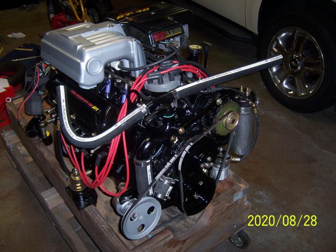

              Originally posted by TG3 View Post
              You are seeing that correctly, the bolt is pressed against the bracket. Unfortunately I don't remember if the old pump did that too and I have sent it back as a core to the rebuilder, so I can't check.
              I posted a picture on the other site that the bolt does in fact rest against the bracket using OEM PCM belts as well. Don't know how many pictures of this you need to confirm.......
              Click image for larger version  Name:	100_2370.JPG Views:	0 Size:	40.9 KB ID:	622899

                        Since it's a rainy day here I did some checking. The pump on my complete engine above has a .006 clearance between the bolt head on the pump and the pumps mounting bracket. I released the belt tension it was still at .006 I then took an extra pump and a mounting bracket, assembled them and measured that one at .020 I would guess yours might be the same. What I suspect is bearing quality- bearings are sold as to grade,obviously the better finish the more they cost. I have done 4 Sherwoods, 2 I sourced my own parts,1 I bought a kit and another was from another pump supply purchased by the pumps owner. The kit I bought advertised as a Sherwood, the bearings,not marked as to manufacturer, before the seal was installed was noticeably rougher than the others. The ones I sourced were NTN's. The 4th pump's bearings were not marked either but were smooth when spun. I'm thinking that the bearings are making some of that noise which is amplified through the mass of the engine. My boat,a V drive,makes so much noise compared to a direct drive so you just notice it more
