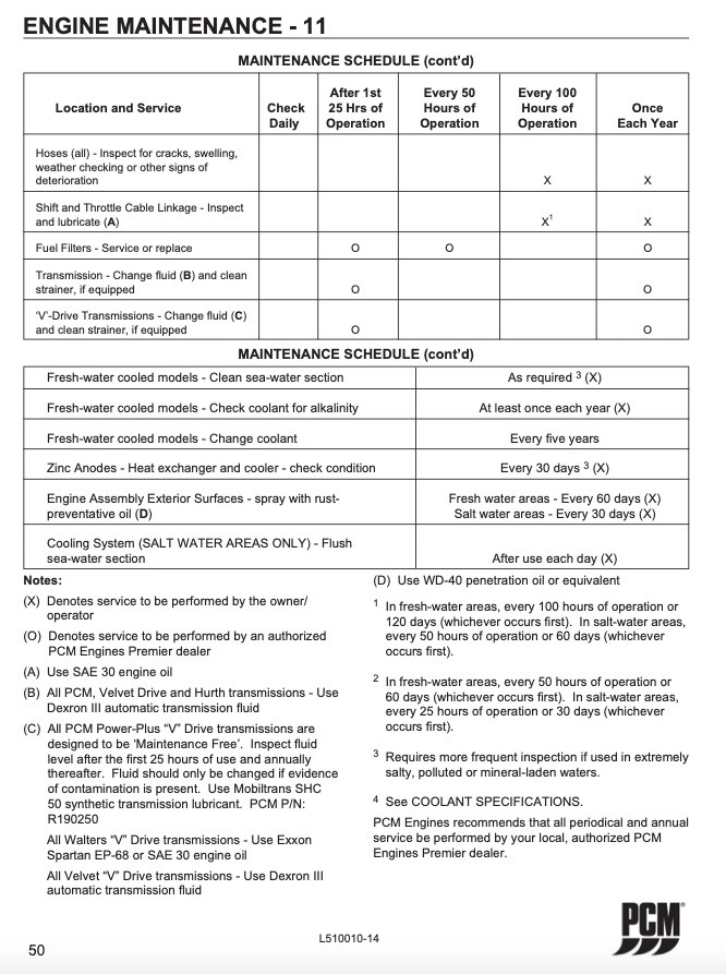

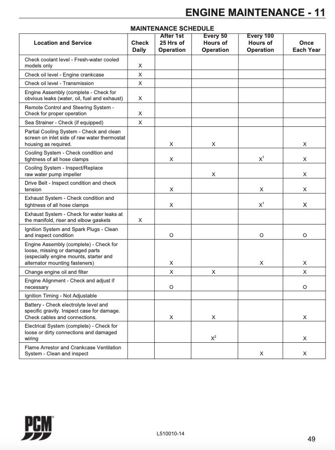

I have a 2014 G21 with approx 345 hours. I do most of my own maintenance as dealership is 3 hours away and really busy. With it being off warranty wondering on suggestions of what else I should be doing. I do all the standard oil and filter changes, lube steering cable and rudder, look to tighten loose bolts, change impeller, inspect belts, change plugs. What am I missing, I know it says to inspect engine mount bolts anyone know the torque for them? Should I be changing fuel filter, transmission oil etc? Thanks
From the 2014 PCM Manual...
