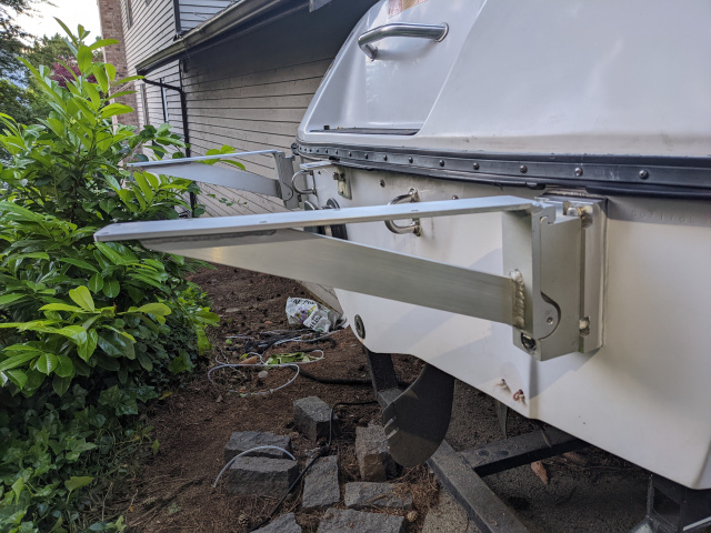

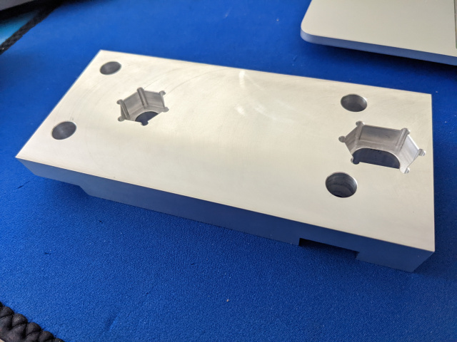

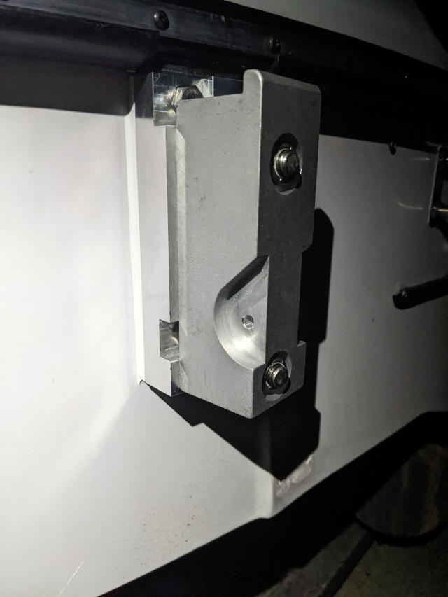

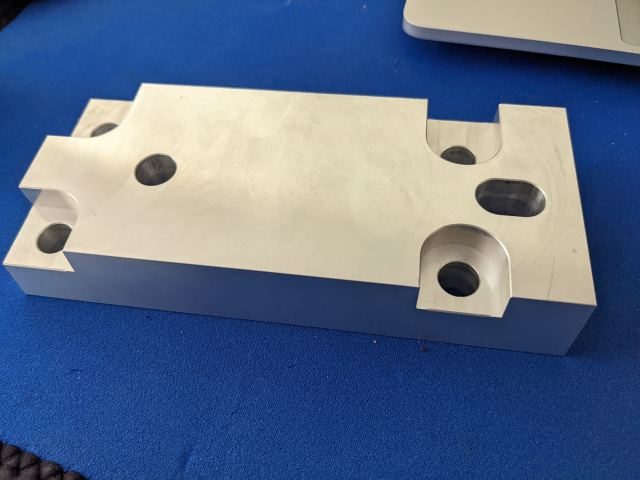

      I had an adapter block machined to allow me to use the newer bracket style. They're a significant improvement over the older style originally on my 2000 SAN. The adapter uses my (4) existing holes to through-bolt the adapter while capturing a pair of bolts (making studs of them) to mount the newer style brackets. Here's a couple photos.
