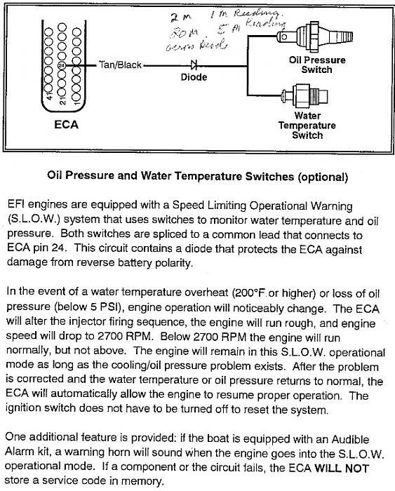

    Very simple. Only two things can activate the check engine light / Limp Mode in a GT-40. One is an overheat condition being sensed, and one is a low oil pressure condition being sensed. If you really are experiencing either of those conditions, you need to figure out why. Sometimes the switches that control the limp mode fail though, and activate limp mode even though there is no real issue. This would cause your gauges to read normal readings, but the switches for the SLOW system are signaling a problem, even though there is none. These switches are SEPARATE from the sensors for the gauges.
    My bet is that the oil pressure switch has failed. You can disconnect the wire from that switch, and that should allow you to run the boat normally until you can get a new switch. It may also be the water temperature switch, and same deal with that, just disconnect the wire until you can get a new one and the boat will run fine.
    Here's the oil pressure switch:
    https://www.nautiqueparts.com/produc...nd-gm-to-2006/
    Here's the water temperature switch:
    https://www.nautiqueparts.com/produc...-mpi-r020014a/
    We're talking about the SLOW system here. See diagram below.
    These are the ONLY things that can trigger limp mode. Nothing else can do it.
    Click image for larger version  Name:	image_47890.jpg Views:	0 Size:	149.7 KB ID:	619929

      Hi Jeff,
      Thank you for your prompt reply. We just replaced the oil pressure switch and the temp sensor. The max rpm I can achieve is 1500, so do you think its something else?
