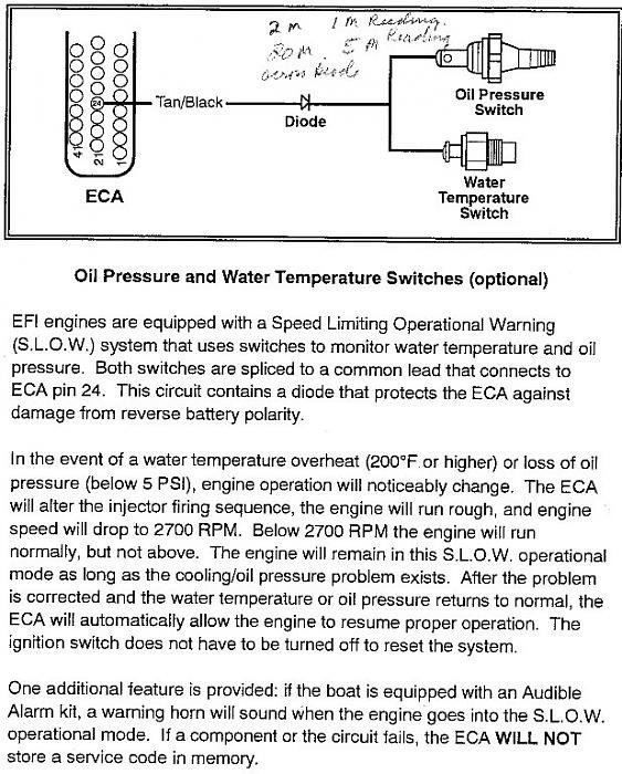

Very simple. Only two things can activate the check engine light in a GT-40. One is an overheat condition being sensed, and one is a low oil pressure condition being sensed. If you really are experiencing either of those conditions, you need to figure out why. Sometimes the switches that control the limp mode fail though, and activate limp mode even though there is no real issue. This would cause your gauges to read normal readings, but the switches for the SLOW system are signaling a problem, even though there is none. These switches are SEPARATE from the sensors for the gauges.
My bet is that the oil pressure switch has failed. You can disconnect the wire from that switch, and that should allow you to run the boat normally until you can get a new switch. It may also be the water temperature switch, and same deal with that, just disconnect the wire until you can get a new one and the boat will run fine.

We're talking about the SLOW system here. See diagram below.
These are the ONLY things that can trigger limp mode. Nothing else can do it.
No O2 sensor, the red light only comes on for overheating cooling water or low oil pressure.Originally posted by Need2SkiT View PostYesterday I was out on the lake with my 2000 Super Sport with the GT40 motor. While cruising it would feel like the boat would just die and then surge again. After a little while the check engine light came on. The boat smelled like it was running rich. We made it back to the dock and I've replaced the spark plugs but all of the plugs seemed fine that I replaced. I've read where some people say it's the O2 sensor and I ordered one but then someone on the Nautique facebook page said the GT40 didn't have an O2 sensor. What should I be looking for? Help, we have company coming next weekend and need the boat back up and running by then. Thanks in advance!
To test you can disconnect both sensors.
The are both switches.
Also check your oil pressure and temp gauges. If the show normal one of the sensors is bad.

Those are the only things that will make the light come on. Nothing else triggers it.
You have a temp or oil pressure switch that has failed. The sensors (not the switches) feed the gauges, so if everything looks good on the gauges and you're still getting a light, one of the switches has failed.Please do not PM me directly asking for advice on how to repair your boat. While I would love to help everyone, I simply do not have time to respond to all of the inquiries. Please post your questions on the forum, so that all of our members have a chance to answer.
Yes. That's limp mode. It happens when the light comes on.Please do not PM me directly asking for advice on how to repair your boat. While I would love to help everyone, I simply do not have time to respond to all of the inquiries. Please post your questions on the forum, so that all of our members have a chance to answer.

Gt40 doesn't have a lambda sensor as Jeff mentioned. As others have mentioned it is likely one of your sensors for the dummy has failed. I can also help you if you need it, I'm in Davidson.

That's the oil pressure sensor it controls the gauge, the should be a smaller one behind it. Don't see it in the picture.Originally posted by Need2SkiT View PostI’m assuming this is what I’m looking for right? There’s a tee behind this and a wire that has a nut holding it off a little round cylinder thing tee’d off this.
Sent from my SAMSUNG-SM-G870A using Tapatalk
That's the sensor. You need to disconnect the wire from the switch (wire that has a nut holding it off a little round cylinder thing tee’d off this).Please do not PM me directly asking for advice on how to repair your boat. While I would love to help everyone, I simply do not have time to respond to all of the inquiries. Please post your questions on the forum, so that all of our members have a chance to answer.
