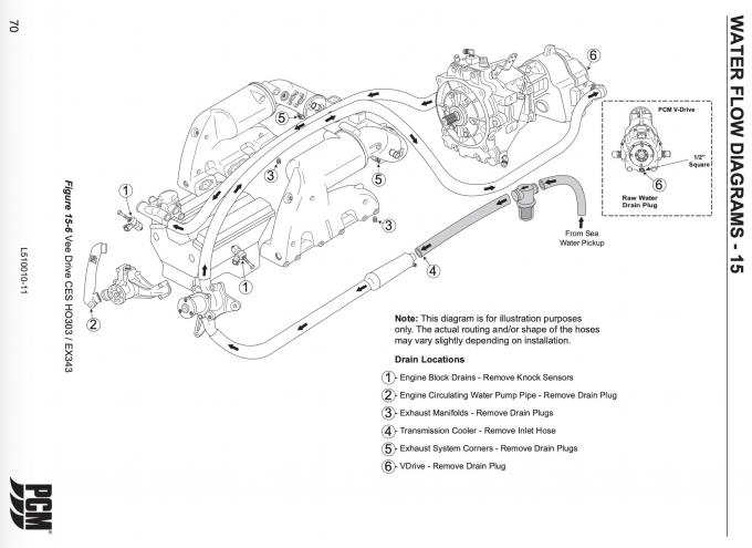

            Still struggling with the temps being higher than normal. Nobody has a clue how much work I've put into figuring this out.
            does anyone know where I can get a schematic of the cooling system for the PCM 343 (raw water cooled)? All I can find is the standard owner's manual.

                  NautiqueJeff...Thank you very much. I know my boat pretty well, but just want schematic just to double check everything.

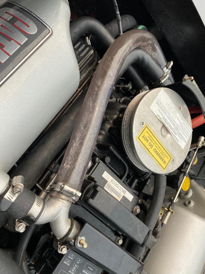

                      When running the boat in the lake, I could feel air surging through the cooling lines. I replaced my top water line with clear tubing to confirm. You can see the air in the line when running. I don't see much change in air with different RPMs.
                      I've pressure tested my cooling system from the intake to the thermostat...no leaks. I do not know where the air would be coming in. Could it be a crack in exhaust manifold, manifold gasket or a head gasket?
                      Does anyone have tips of how I could diagnose the exhaust for a possible gasket leak?
                      Where else could the air be coming in?

                        From the cooling diagram that Jeff provided and your picture it looks to me like the clear hose is the first place the water is going to the engine. I count nine hose clamps, a water strainer o-ring, and the RWP seals and bearings, between the water pickup and hose showing the bubbles. this is all before entering the engine or exhaust manifolds.

                          I have checked, tightened, sealed, bore scoped, many times. I pressure tested the cooling system from the thru-hull, transmisson, to the thermostat. It'll hold 30 psi of air for 20 minutes.
                          I don't fully understand the directions and routing of all of the cooling system yet, but that clear water line in the pic is a return to the thermostat from the catalytic converters.

                              Guess the drawings are lacking in the completeness of your system. I don't see any of them showing Cats in the water flow. How does the water coming out of the cats get to them?
