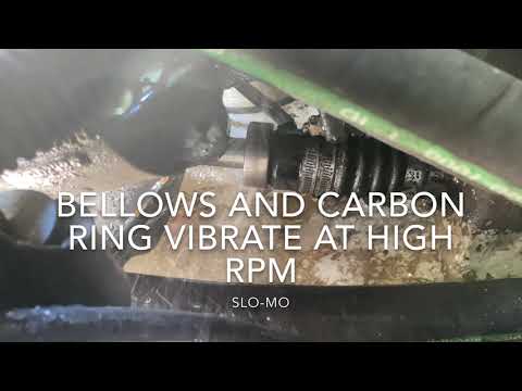

We noticed recently that our dripless seal (PSS) has been leaking the entire time that we're wake-surfing. It only leaks at high RPM 2500+/High speed. I'm not sure what needs to be done to remedy this (video below). I ordered a replacement set-screw kit as the initial thought is that maybe there wasn't enough pressure from the bellows, but after pushing on the bellows it definitely seems like plenty of pressure as I can't easily push back the bellows at all.
However, I do notice that the carbon ring sits about 1/8" below the top of the stainless collar - not sure if this matters. While I can't compress the bellows easily by hand (super hard to reach under the V-drive) I can push up on the carbon ring which breaks the seal and lets water in.
Thoughts? It's not causing any serious issues, just bilge coming on after every time we wake surf, but I know the PSS is supposed to have zero water coming in.
