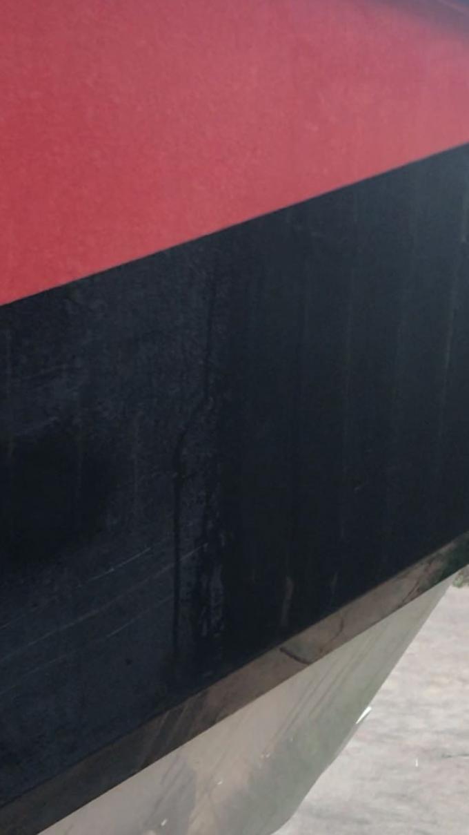

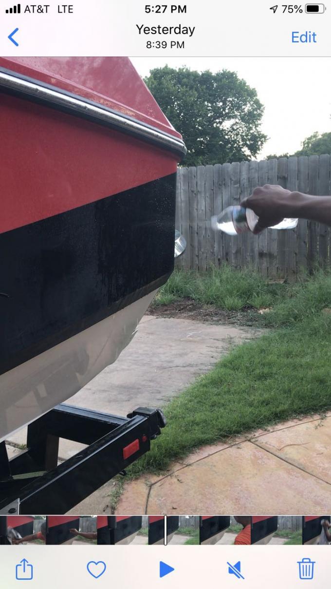

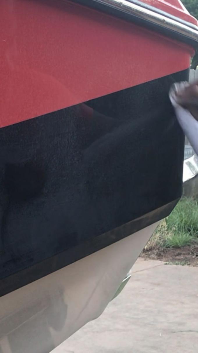

My wife and i went to Lake Powell. I didn’t wipe the boat off after we loaded. The boat was completely covered with hard water stain. I saw a recommendation to use a solution of 50/50 water and vinegar. I did so. It worked amazingly!! Curious what everyone else uses as an after-lake cleaner.
Vinegar works but will also strip off the wax. Check out Boat Bling Hot Sauce or my favorite Boat Juice. They easily remove water spots but leave a nice coat of wax too.

I second the hot sauce. Takes off the water spots and keeps it feeling waxed.

Yes some lake water is more prone to spotting than others. A water spot is a calcium deposit. When the water evaporates, it leaves the calcium behind. This is why vinegar & water is so effective at removing them. It dissolves the calcium.
