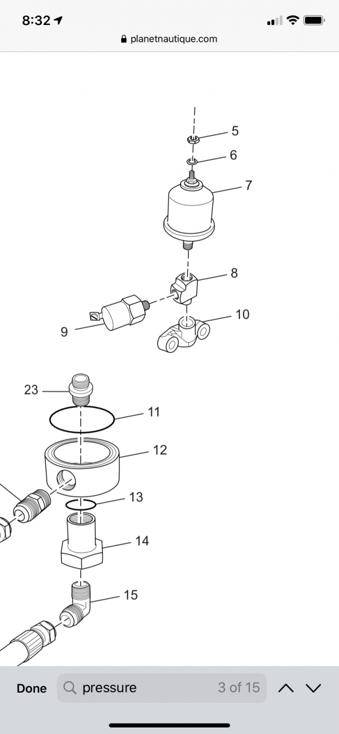

            I agree, It supposed to be on a T bar with the sender. What was the sender attached to? Pic?

                Which year manual did you see that in? I have a 2006 with a ZR6 and mine has one (I’ve replaced it so I know it’s there). Here’s a pic From the 06 manual where 7 is the sender, 8 is the T, and 9 is the switch. In mine, the T was physically larger and looked more like and actual T shape.
                  From the 07 manual which I got from the section on this site - https://www.planetnautique.com/Corre...07/20076.0.pdf Also, I just replaced my oil sender 2 weeks ago. I did not see a switch anywhere and couldn't find a part for it on the parts site I was using.
                  Here's the screenshot of it. I'm not sure why the change from 06 - 07 maybe a different engine????

                    Thank you all for posting the diagrams! It turns out that my 2007 5.7L engine does not have that switch, I spoke to the local Nautique dealer and there is just a cap on the other side of the the connector piece on my engine. We replaced a couple of other sensors and I still get the engine light when transitioning back to idle. It's likely time to get a fault code reader, I've spent a lot of time and $s shooting in the dark.
