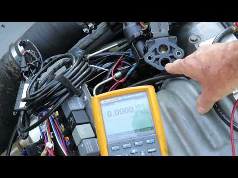

      I just watched it, thank you for it very helpful. I will do the test. You said if the channel in there is dirty, I should clean it. How do you recommend I do that?

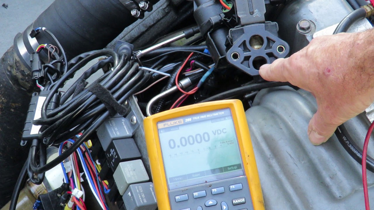

        I did the tests and here's the outcome. The valve was 90 degrees when I measured this.
        - Left wire, 12.34 volts, good getting power.
        - Right wire also has 12.34 volts when the boat is not running but has ignition on.
        I took off the IAC and it worked as depicted in video. I cleaned out the channels and the gaskets because they were very dirty.
        - While the boat was running I got 11 volts at the left wire and anywhere from 7-5 on the right wire. It was seven when it started cold and then as the idle went down the volts went down.
        I didn't start the boat with the throttle after I cleaned out the channels and it fired right up cold.

          Looks like the valve and valve control are ok, and your bypass air channel was clogged.

            So do you thing the clog was the issue all along?

              Well it makes sense the bypass opens on start up to provide extra air, if its clogged the engine does not get enough air opening the throttle fixed that problem.
              Is it starting with throttle in idle all the time now.

                Is the problem solved?
                Peter6000 - really enjoyed the videos on the sensor checks. If I can ask, what's your background....you operate like a professional mechanic. I saw you mentioned you had swapped out the factory ECU on GT-40 with a different unit....
                NautiqueJeff - might want to consider some sort of sticky for both of those videos for other GT-40 people trying to sort out run issues.

                  I think thew issue is solved, but I will wait to say for sure.

                    I have started the boat around 3-4 times today and none of my starts need throttle. I think this particular issue Is solved, but I still need to do the other manifold.
