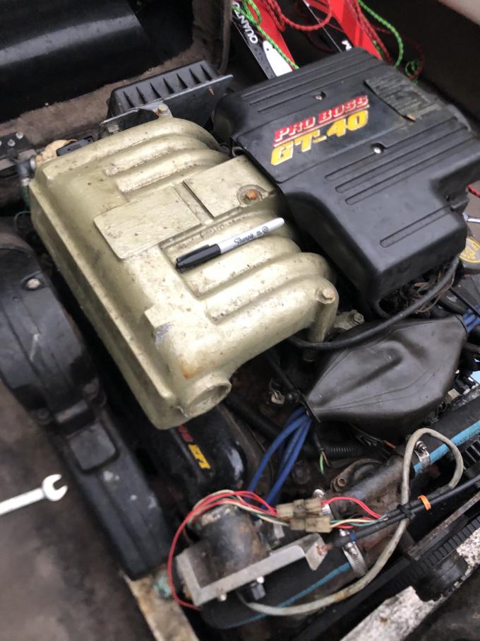

Take a picture of the engine and post it its most likely a gt40.Originally posted by 97nautique* View PostI don’t know what engine it is, is there any way I can verify with you what it may be just from looks or numbers. I think it says boss on the valve covers if that helps.

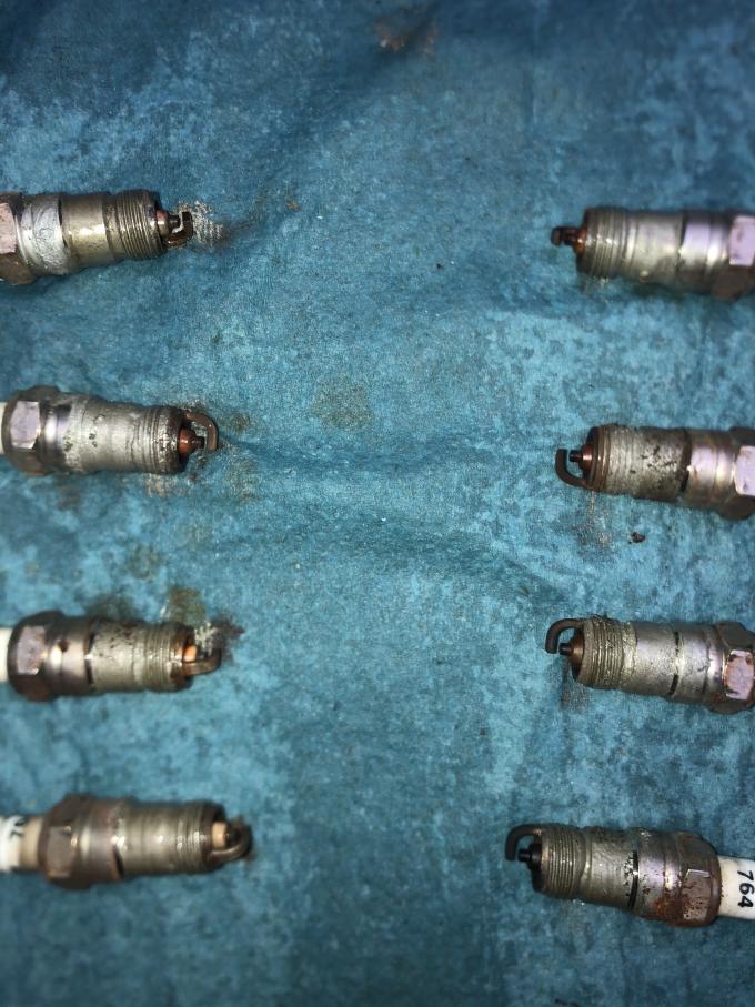

Take all sparkplugs out an compare them may post a picture.

Update:
- Engine is most definitely a GT40 because it says gt40 pro boss on the valve covers and on top of the engine
- The spark plugs need to be replaced. What ones should I get and what is there gap going to be?

Now here is the fun part, after taking all the spark plugs out and inspecting them, I left them out and cranked the engine. When I do so, the motor turns with no clunking noise so far, it can now make a full revolution and then keep going. But when I am cranking the motor, the starboard side pistons shoot out a watery and brown fuel mixture as pictured below. The port side doesn't do this. I am starting to think that the water is in the starboard cylinders because that same sides manifold may not have been letting the water escape out the exhaust, but I don't know. What do I do from here?
I do not know if you guys can see these image links but I'll give it a shot.
You're getting water in your cylinders. That's bad. Like really bad.
The issue where "your starter was hitting something" was the compression raising too high for the starter to be able to turn the engine, because there is water in the cylinders, and water does't compress like air.
You need to find out why this is happening before you attempt to run the engine anymore or you risk the hydrolock condition bending a rod, and then you're in even deeper.
Was the engine winterized last year? I'd look for a cracked water jacket or other freeze damage, based on your location up north.
You might get lucky and find that it is an exhaust riser gasket that failed on the starboard side because of the overheating manifold (which could theoretically allow water to back flow into the cylinders on that side), but it is certain that that engine has some issues. For that manifold to have overheated like that, I would still suspect a past winterization issue, or some substantial salt water use.

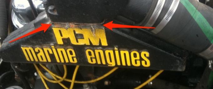

I hate to say it, but I really doubt the exhaust riser gasket is your issue. It is possible, but unlikely. To check it, you need to remove the four bolts at the exhaust elbow and remove the risers from the manifolds. The problem is that the bolts will almost certainly break when you try to remove them, especially after salt water use, and you'll end up drilling them out. It is not fun.
Normally, exhaust riser gasket failures will show themselves by a rust stain near the gasket, running down the manifold. They can leak like this for years before they cause any water to enter the cylinders though. I have worked on tons of Nautiques, and I have never had one where an exhaust riser gasket failure led to water in the cylinders. It is possible though. Do you have major rust stains or drip marks here?
