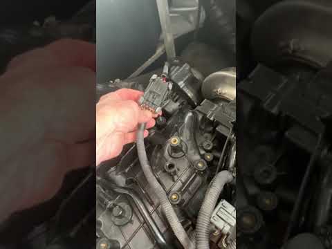

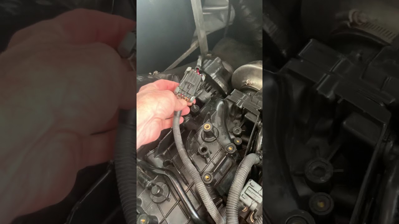

      Ok so here are the results. This may not be the case for all ZR6 engines, however it is the case for mine. The diagnostic port on my 2006 PCM ZR6 6.0 is located on the right side of the engine when viewed from the rear, rear being opposite of the pulley's. In this case it is in a V-drive boat so the front of the engine faces the stern.
      The diagnostic port is a rectangular 10 pin connector. It is plugged into a matching connector that only has 2 wires. See the MEFI diagnostic sheet that identifies the plug.
      Whats unique about this plug is that typically these are capped off and you just uncap them and plug in (generally speaking). The opposing 2 wire plug sends information to the Faria Gateway under the dash. The 2 wire plug that is plugged into it is the same 2 wire triangular plug that enters the gateway with the sticker that says ALDL for "Assembly Line Diagnostic Link". It is through this harness that the ECM sends codes to the Faria Gateway. If you un-plug this connector the engine will stop sending information to the gateway and any alarms you are seeing in the digital display on the Tach will go away, because you just eliminated the feed, the code may still be present, but you can now read the code through this link.

                Andy - please look at this youtube if you get a chance. I am trying to figure out the cable routing for the diags cable. I see on your photos that perhaps yours goes straight back across the cooler on the port side, but I can't tell if that's the same cable or not. thanks for any help.
                • Andy Gardner
                  • Jun 2020
                  • 13
                  • Asheville NC
                  • 2006 CC Air 226 Team Edition w/ ZR6
                  Thats it. Mine is a little different, it runs straight out towards the stern across the mufflers on the port side muffler. I also do not know where that mounting tab goes, no clear answer for me either. I zip tied mine just outside the ZR6 cover so it was accessible without the removal of that cover. The 2-wire (red & black) side of that plug sends data to the faria. You can run the engine without that plugged in. It just stops sending data to the faria, gauges go dead.
