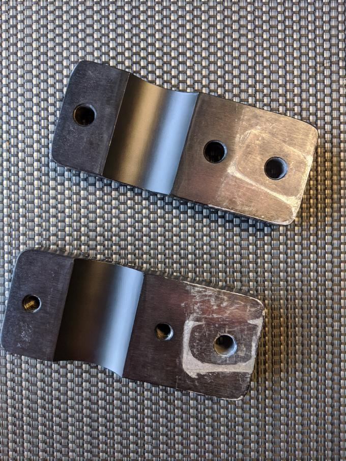

                    OK. Turns out (news to me but makes sense) you can order small bits of car vinyl wrap from Amazon and others. So I got a small piece for $10 and covered the inside curve portion of the block. I think this will work nicely.
                    Not that you can see much here as the block and the vinyl are both black...but here's a pic post install.
                    . Click image for larger version

                      Just as a follow-up, this solution is working.
