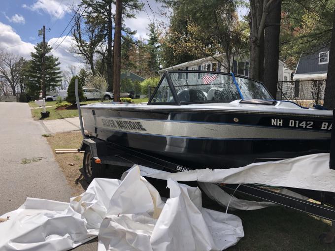

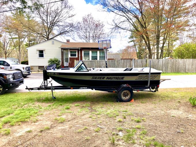

    Anyways very close to purchasing a 1986 Silver Nautique. I’ve looked at it twice and everything checks out.
    400ish hours. Started up very nicely and purrs like a kitten. Interior in great shape, all accessories work etc etc.
    For a 34 year old boat it’s in amazing shape and the silver flake and black hull just pop.

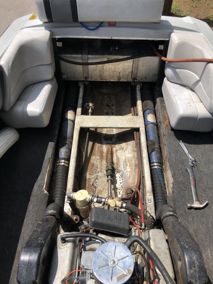

    I removed the floor behind the engine compartment and the stringers from what I could see, looked and sounded very solid. Motor mount bolts came out as clean as a new SS lag from the hardware store and had very strong bite going back in. Insane documentation on maintenance dating back to original purchase. Well maintained.
    My ONLY hang up and reservation is the floor where your feet would land when sitting on the observers seat is soft. About 12-18” are clearly separated from the hull side. It’s the only flaw I could find that gives me reservation.
    I would love to pull the floor, replace and sea deck. Pipe dream? Lots of posts showing can of worms once you have a soft floor spot...stringers et al.

        That section of the floor is wood The rest of the floor is glass over foam. If that area is soft you can almost guarantee the front part of the stringers aren’t far behind especially since you say the floor and wall are already separated. That area up front under the seats is where most of the rot ends up because its not able to air dry very well.
        Once floor separates from the wall that’s when you can start to develop stress cracks in the gel, I would look that section over real well.
        I went through that with my ‘85 ended up doing a complete stringer job.
        Also for some reason the silvers seemed to be susceptible to blisters in the gel on the bottom something else to look out for.

            That’s the problem you really can’t, it’s all enclosed.

                  The reason you don’t see write-ups on just the floor is because it’s unusual for the floor to rot and the stringers be fine. I’ve always heard boats rot from the inside out and my experience shows that to be true. That is one of the first areas to show rot (other than the piece of wood in front of the ski pylon) so you may get lucky but don’t pay for a 34 year old boat showing signs of rot and expect to just need to do the floor. I’d also consider getting your ccfan info sorted or set up a new account if you plan to tackle this.
