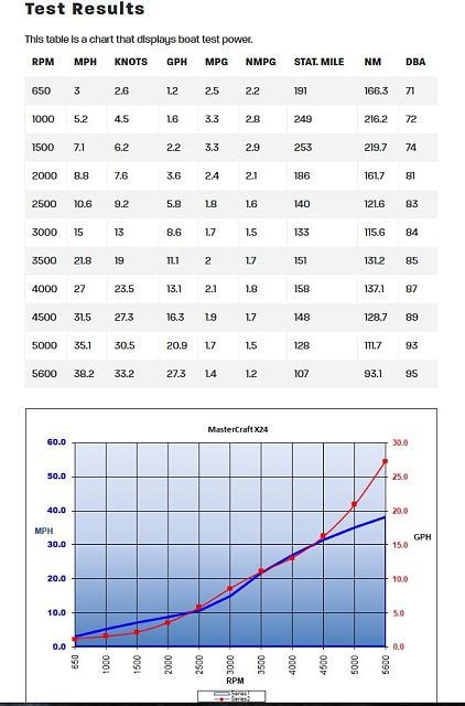

            The physics are such that the drag increases by the square of the speed. All things equal increasing speed requires significantly more fuel to overcome the increased drag. You can see this in fuel performance results for the many boattest.com results. Here are results from the MasterCraft X24. See: https://boattest.com/boat/mastercraft/x24-2020

              Interesting chart...thanks for posting.
              The data supports my thinking that the boat is more efficient as it exits being a displacement hull (think surf) and moves to a planing hull (think wakeboard). You can see it in the MPG numbers....MPG decreases significantly in the 7 to 13 knot area and then rises again in the 19 to 23 knot zone.
              Buuuuuut...it's pretty marginal...I might have expected a higher increase % than what's in those numbers.

                Plowing thought water might feel LESS efficient and planning on the surface might feel MORE efficient but in fact the exact opposite is true. This is why most transport ships are displacement hulls. The MPH data likely have more to do with the prop used for this application than the efficiency of the hull. A google search on the subject will show this. For example: https://www.soundingsonline.com/boat...l-form-for-you
                A planing boat goes faster as more power is applied, with no clear upper speed limit because it flies, its bottom supported by water pressure much as an airplane’s wings are supported by air pressure. The only practical limitation to a planing boat’s speed, in fact, is determined by the size of the waves; the boat’s size, bottom shape, strength and integrity of construction; and the tolerance of its passengers.
                The problem with a planing hull is its great inefficiency compared to a displacement vessel. It takes a great deal of power to get that boat up on the surface of the water, and the result is very low “transport efficiency,” as it’s called. Transport efficiency can be applied to any form of vehicle, and it simply refers to the amount of energy it takes to move a given weight of cargo a certain distance.

                  My observation about is not related to MPH but to MPG. At a low speed, the volume of water displaced is low...but as you increase the speed of said displacement hull, it must displace water at a faster rate...this is expensive energy-wise as the volume of water to displace is now high and the water itself is heavy. The outcome of this is a larger wake. Now, as the hull starts to transition from displacement to planing, this is where there is a brief period where the friction of the planing hull requires less energy than high speed displacement hull. You can see this point in the MPG figures. Now...as the boat continues to accelerate, this benefit is lost and the MPG again drops but this time the energy is primarily used to overcome hull friction (and air resistance) and less water displacement. You can see this as the wake gets smaller as the speed increases.
                  In practical terms, I experience this as the boat rises to a plane and I have to throttle back else the speed rapidly increases.

                    OK. I see your point. Yes, there is that period where the boat is climbing its own bow wave, is not yet on plane and is operating in an inefficient regime as a displacement hull. Accelerated past that point drag is reduced as the boat reaches plane but quickly increases as hull speed builds. In my prior post I did mean MPG, sorry for the confusion I miss-typed it at MPH. I believe surfing does not really operate in that no-mans land where the boat is riding up its own bow wave immediately before planing. If I recall that happens at about 14-16 MPH while surfing is done at 10.5 - 11.5 MPH and explains why all things equal surfing can be significantly more fuel efficient compared to wake boarding. All the best.

                      The rpm's are so low when surfing that the gph is less then boarding. Yeah. Ok fine. Obviously rpm less gph will be less. See your own chart.
                      But me thinks you have to do the math. If you wakeboard for 10 minutes a set vs some dude surfing for 20-30 minutes a set...Probably not much difference in gas used.

                            Look at your chart. as rpms go up gph goes up...wow. big surprise...obvi wakeboarding use more gph then surfing...wow. You state the obvious on so many posts and i am dumb...
                            here your obvi b.s. "surfing is done at 10.5 - 11.5 MPH and explains why all things equal surfing can be significantly more fuel efficient compared to wake boarding"....yeah. you brilliant.
