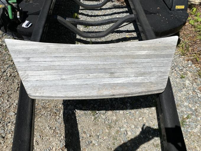

Project time! Giving life back to my teak swim deck of an ‘01 SAN. Have the Starbrite 3-step kit, seems to do the job by most people’s accounts. But the teak needs some love first. Recommendations on sandpaper grit, approach, tactics to use? Thx!
Did someone stain the teak? I’m normally against sanding. No matter what grit you use it will be too slick. But if that’s stain or paint I think it’s your only option. 80 maybe then a 120 is what I’d probably go with. Get that off of there and then use a nice teak oil. It’ll take a lot of coats this year but if you clean it thoroughly now and keep teak oil on it you can do a light coat every few months going forward.
Yep. Spend a couple of hours sanding that down, then just hit it with teak oil. Don't bother with the three-step kits. Sanding and oiling is what I always do, and the results are always great.

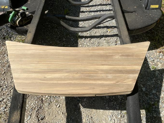

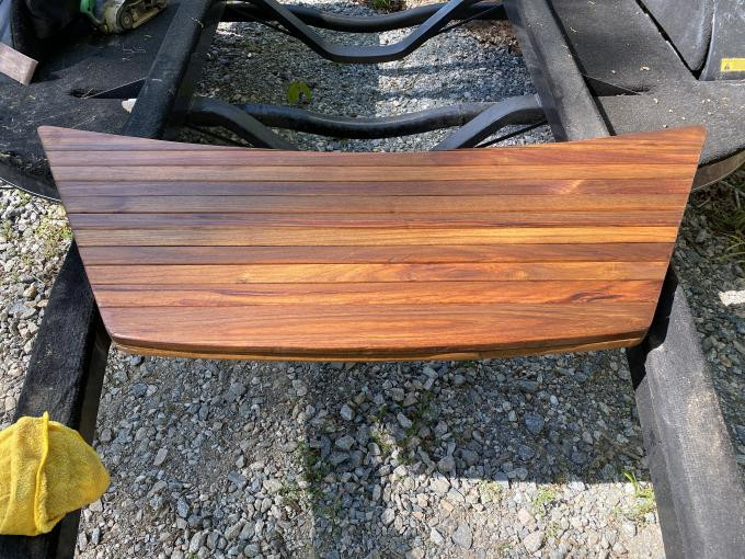

Here's the last one I did (on my recently-sold 1999 SNOB).
NautiqueJeff Interesting. It looks great! So skip the three-step and just hit it with oil? What brand did you use for that teak deck in the pictures? How often do you re-apply?
Yep, just sand and oil. Those three-step kits are a waste of time. They take forever, and don't work nearly as well as just sanding and oiling. Should last quite a while.
I use Starbrite teak oil. I do a lot of these, so I buy it by the gallon on Amazon.Please do not PM me directly asking for advice on how to repair your boat. While I would love to help everyone, I simply do not have time to respond to all of the inquiries. Please post your questions on the forum, so that all of our members have a chance to answer.
Jeff - do you prefer brush or wiping on with a rag?Originally posted by NautiqueJeff View PostYep, just sand and oil. Those three-step kits are a waste of time. They take forever, and don't work nearly as well as just sanding and oiling. Should last quite a while.
I use a rag. I usually end up applying about ten coats. Apply one and give it time to soak in, then apply another.Please do not PM me directly asking for advice on how to repair your boat. While I would love to help everyone, I simply do not have time to respond to all of the inquiries. Please post your questions on the forum, so that all of our members have a chance to answer.
