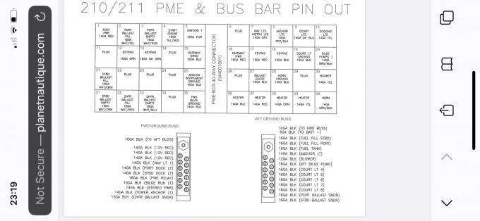

                      The click from the PME box (if I’m thinking about the same thing) must be a breaker tripping, there are not any relays in there for the bilge pump circuit. When trouble shooting on older boats I generally hunt for voltage drops as opposed to continuity. All too often, a bad/corroded breaker can cause lots of problems. Run a separate cable from the output on the PME box to the bilge pump to verify all in order upstream so to speak Then it’s just a simple case of tracing the wiring back and testing. If it’s not working when you have the other cable in place,it would suggest a bad breaker if you are gaining continuity and no voltage

                        I’m not sure if I am capable of that lol. I did see the wires coming out of the PME but no idea which one would be for the bilge wire. Something to look at for sure because I’m all out of leads so I just plugged the bilge pump into the ballast wire and when I need to pump pit the bilge I just hit the fill button on the key pad. I hate doing that tho. I want it to be right. Also the rear pump don’t work at all because it’s on the same power wire as the front one. . Not sure why they did that. You go from 2 pumps to none if something happens.

                          I had a wiring diagram for a 230 that helped me isolate some wires on my 210. I’ll dig it out and send to you
                          • ally505
                            • Feb 2012
                            • 180
                            • Somewhere cold and wet
                            • 2008 super air nautique 210, zr6.
                            Here you go

                              Originally posted by ally505 View Post
                              Here you go
                              awesome thanks.
