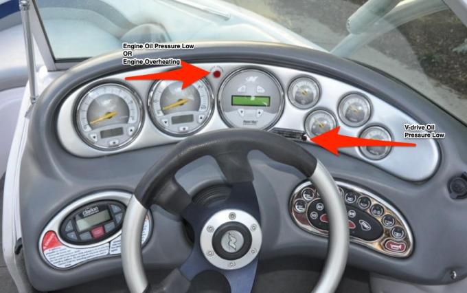

We are testing a 2004 SS. The red dash light stays lit. Is that the v-drive oil pressure light or is that an engine oil pressure light? Does anyone know?
The big red check engine light will come on if the engine has low oil pressure or is running hot (or if one of those switches is bad).
The little red light will come on if the oil pressure in the V-drive is low.
Assuming you're talking about the big Check Engine light, if the temperature and oil pressure are normal, it is very likely that the oil pressure SWITCH is bad. It is a common issue, and an easy fix. If the temp and oil pressure are good, I would not let that light stop me from making a purchase.
