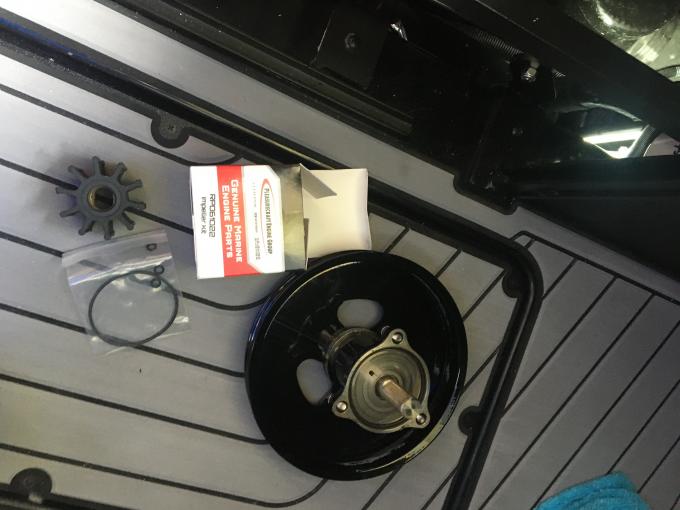

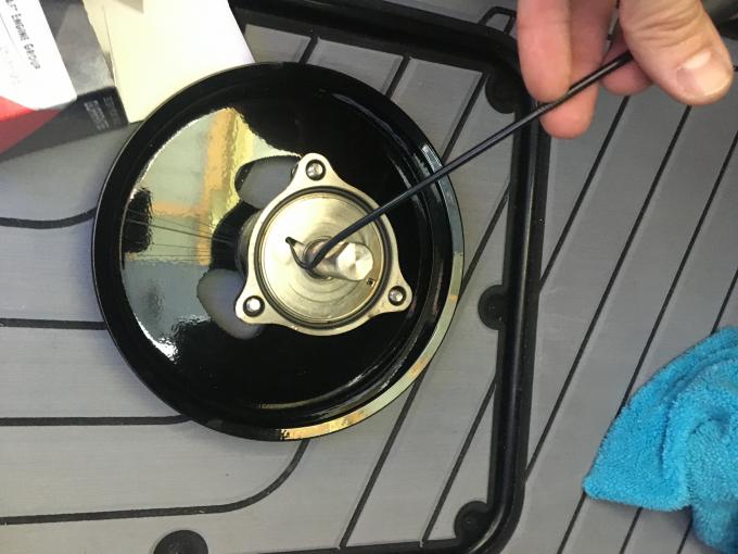

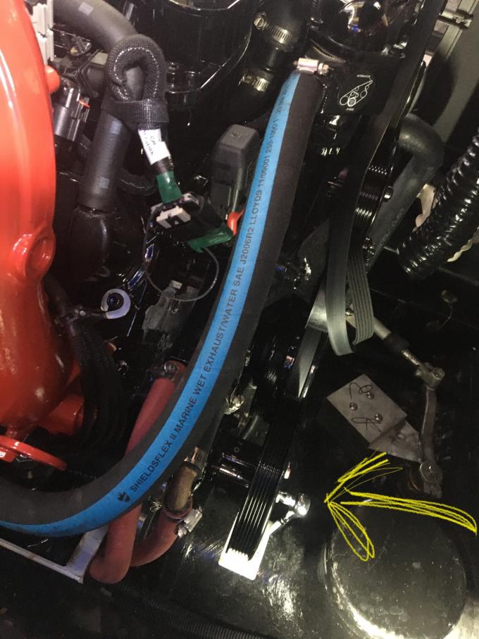

    Took approx 20 mins. Very simple.
    tools needed:
    1/2” drive ratchet or breaker bar with 1 - 2” extension to pry back the belt tensioner and remove the drive belt
    1/4” drive ratchet, 10mm socket, on a 3-4” extension to remove the 3 bolts to the water pump

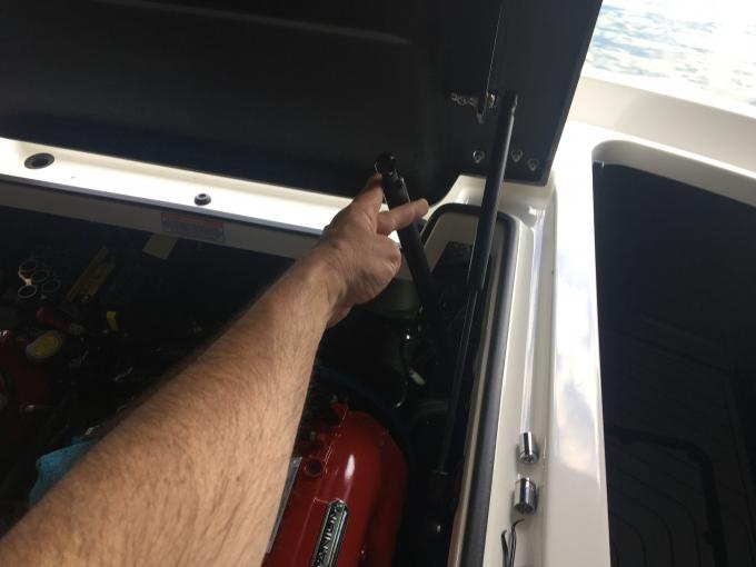

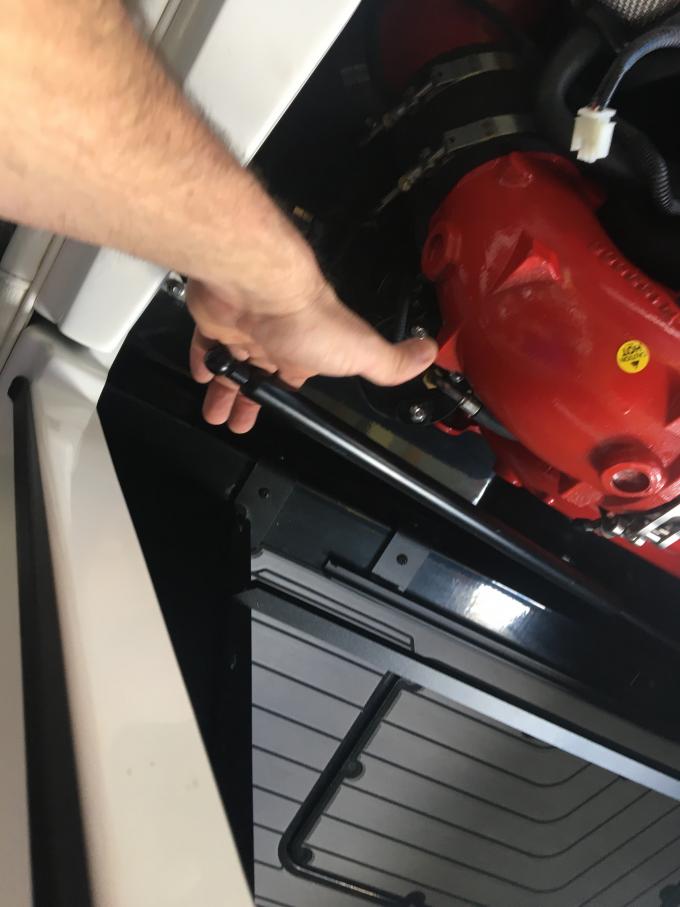

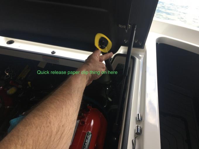

    1. remove the gas shock that’s in the way... takes 10 seconds removing the paper clip thing on the top of the shock

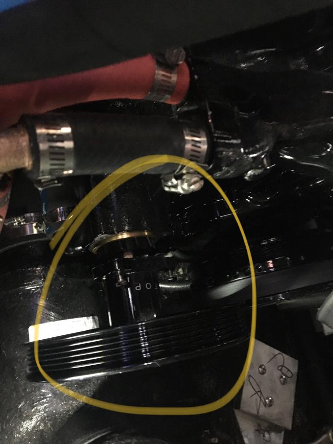

    2. use the 1/2” drive ratchet and pry back the tensioner and remove the belt from the water pump
    3. remove the 3x 10mm bolts on water pump with the 1/4” drive ratchet
    4. wiggle the impellor out ****-eyed and crooked using the flywheel spline. Else you are into using pliers.

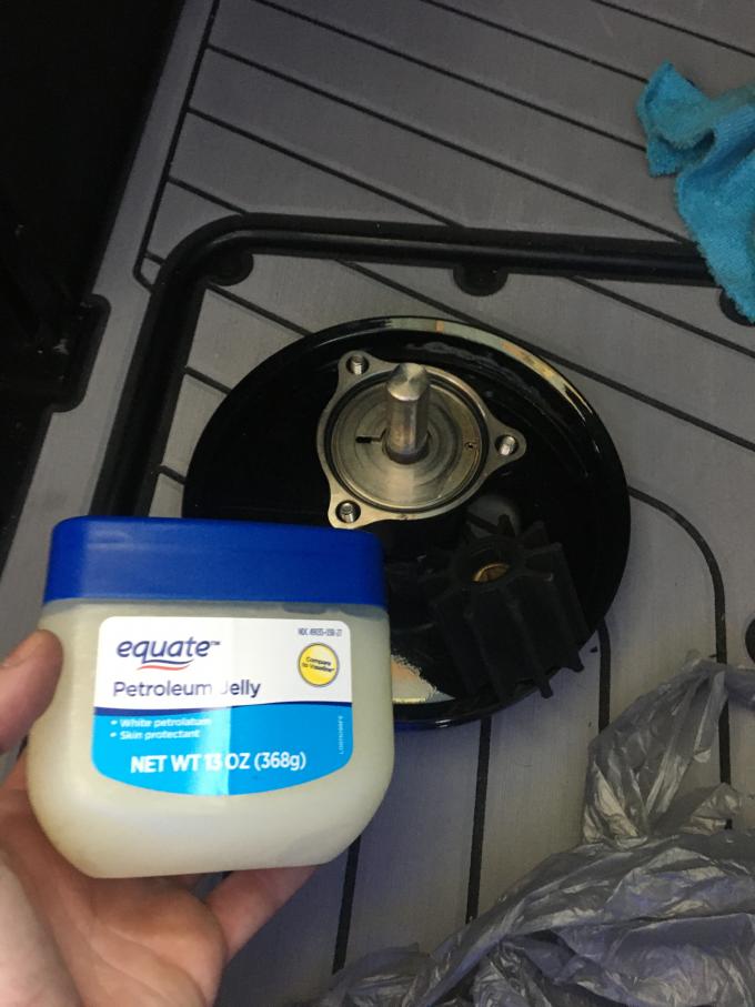

    5. replace and reassemble!

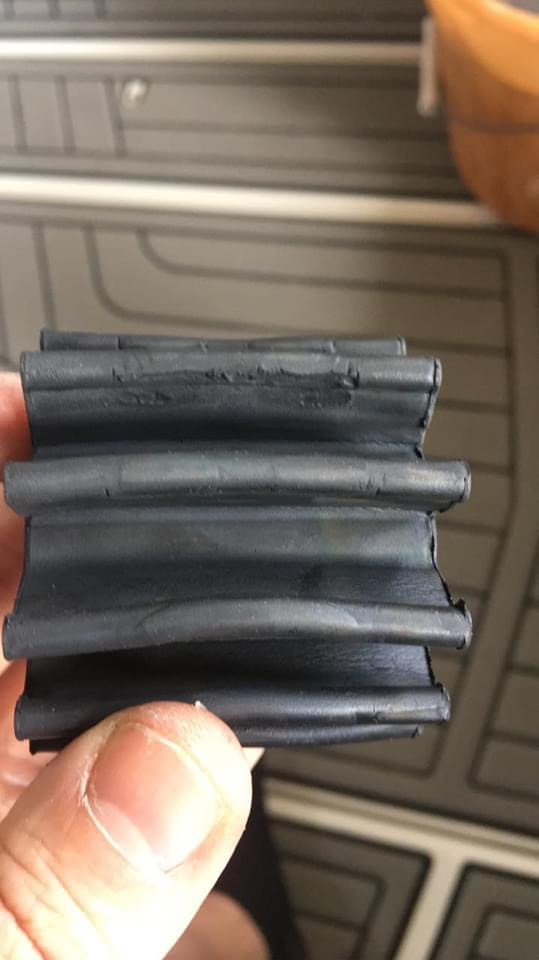

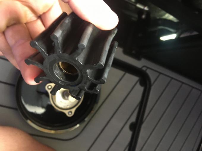

    This original impellor only had 45 hrs on it

      Gas shock quick release
