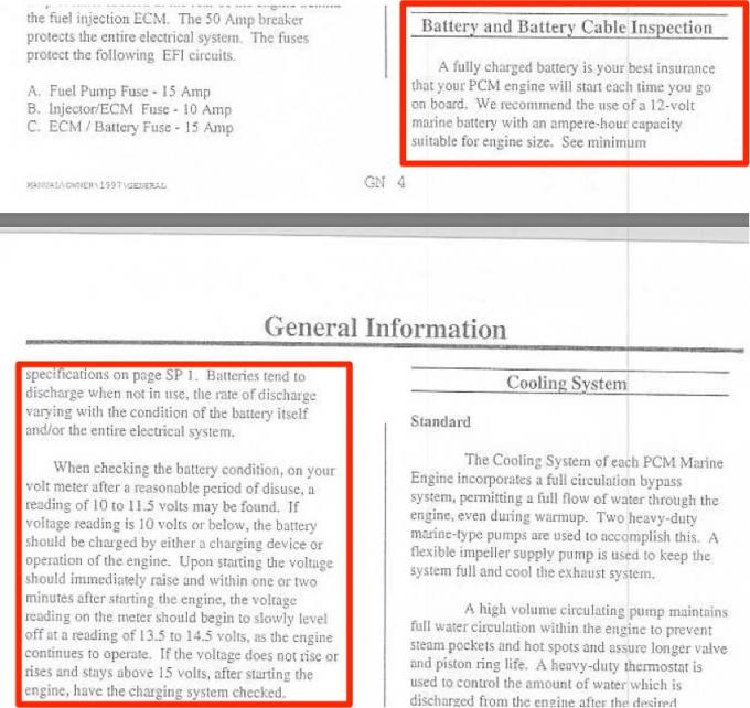

Here's the snippet from the 1997 manual.
Also, based on that picture, you might want to consider replacing those old battery cables, especially since the ones you have use crimp style connectors. Those are notorious for allowing corrosion into the wire itself in a marine environment.
