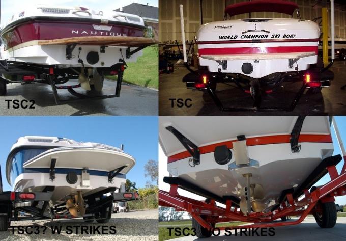

Hello all, first time posting, but have been reading these forums for months. I have a question I hope the forum can help with: I just put a deposit on a 2004 196 over the weekend; the boat is in great shape overall, and the seller is the second owner of the boat. The boat is currently winterized, so I'm having it taken to a dealer for a pre-purchase inspection (not a full survey or anything, but just asked the dealer to do a compression test, take it for a lake test and let me know if anything major is amiss). One thing has me puzzled. From my research on these forums and reading through the brochures, the Hydro-Gate was not an option on the 196 until the TSC3 hull in 2006, but the boat I am in the process of buying has the gate and control installed. The gate and controls look to be factory and perfectly match the pictures from later years. I guess it could have been retrofitted at some point, but want to know if this should concern me? Is there anything specific I should have the dealer check for re the hydro gate?

Below is a picture of the helm, I don't have one of the gate itself, but once I take delivery (unless the retrofitting of the gate is an issue with the boat?) I'll make sure to get better pictures and upload them...
