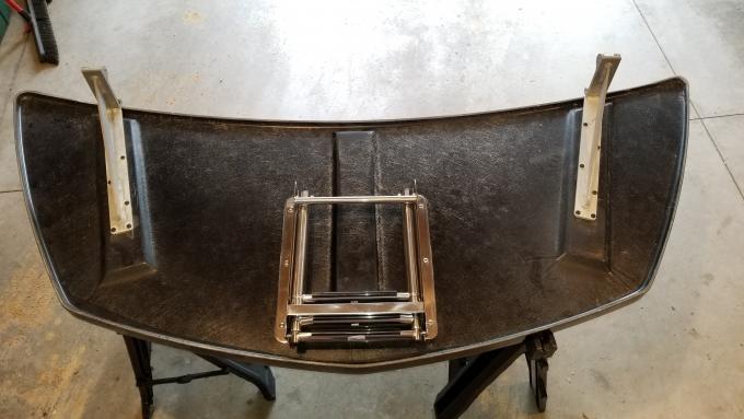

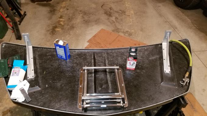

Having the Garelick telescoping ladder and recommended fasteners in hand, I was surprised to drill into the swim platform and learn that the core was foam-filled. What I thought was going to be a quick project turned into Plan B, which has worked so far.
Plan B involved procuring the largest package of J-B Weld that I could find along with some plastic livestock syringes and large needles. I marked and drilled all of the holes for mounting the retractable ladder and then bent a coat hanger into a small "L" so that I could remove about 1" diameter of the foam inside of each hole. I used compressed air to blast out the loose foam. I then marked the outside of the ladder with painters tape and used an angle grinder with a flap disk to rough-up the mounting surfaces of both the swim platform and the ladder. I mixed the J-B Weld and proceeded to fill each hole with the syringe and spread an ample amount of the epoxy on the roughed-up mounting surface before mounting the ladder with stainless screws and flipping the platform to its service position to let the epoxy flow around the screws. With the ladder epoxied to the platform, I doubt the screws are doing much work.
We have only tested it with 215 pounds (me, fully clothed on dry land) but it has held so far.
Makes sense, and better than any solution I'd come up with, thank you for the photos too! Love this community! I'd like to check back in following some real world use, but seeing you're in MN, that might be longer than my winter project season might allow. Did you consider taking a grinder to the entire section and doing fiberglass/epoxy over something to drill into? That was my first thought, but wonder if you'd thought of something I'd missed that kept you from doing it that way? Thanks again
It was used on the water all last season without incident. I just mentioned the "fully clothed on dry land" as that is the most weight / leverage it has been subject to, since the force of standing on the bottom step in the water would be somewhat decreased by my natural bouyancy. I did think of creating a surface to drill into, but wanted to keep the ladder as tucked under as possible and didn't think it necessary with the entire ladder mount and screws epoxied to the platform. I figured I would reserve that as Plan C if Plan B tore out.
