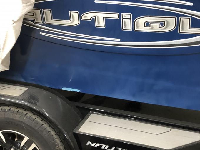

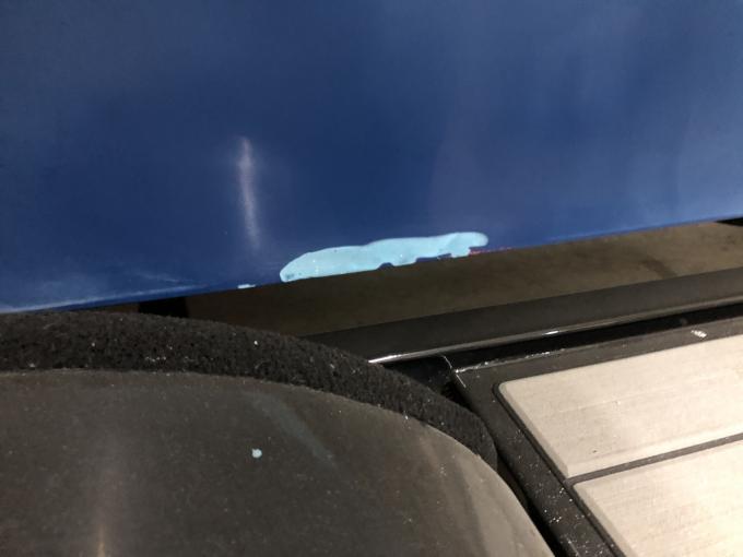

Spectrum Colors has gelcoat patch kits to match your hull color. I have used their product and have been pleased with the results.

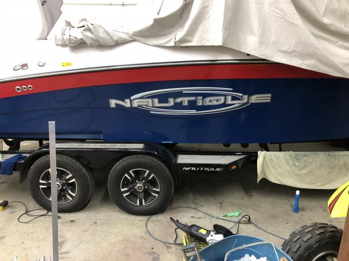

You'll need to grind out the wrong color gelcoat and use what GMLIII recommended.
Those aren't water stains, those are areas of oxidation in the blue. You'll need to wet sand and polish those with the appropriate products.Please do not PM me directly asking for advice on how to repair your boat. While I would love to help everyone, I simply do not have time to respond to all of the inquiries. Please post your questions on the forum, so that all of our members have a chance to answer.
Mike Phillips on Autogeek.net has a good marine detailing book. It is worth its weight in gold if you are new to gelcoat.
You might be able to knock out that oxidation with a rotary and a course wool pad followed by a finer pad and polish with an orbital to take out the rotary holograms. But you might need to use something like these and wet sand, however:
https://www.boatersplus.com/3m-marin...All%20Products

The dealer that sold me my boat must have some majic product that they use to mask the oxidation because as soon as I used the boat those marks appereared, two weeks at Lake Havasu in the marina, i would think that it would not oxidize that much in 2 weeks.

By the way, to do this right, you could pull the vinyl graphics off the side and replace those too. That'll cost a little more, but you'll get a full buff and have new graphics too.Please do not PM me directly asking for advice on how to repair your boat. While I would love to help everyone, I simply do not have time to respond to all of the inquiries. Please post your questions on the forum, so that all of our members have a chance to answer.
