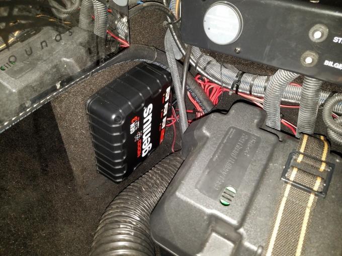

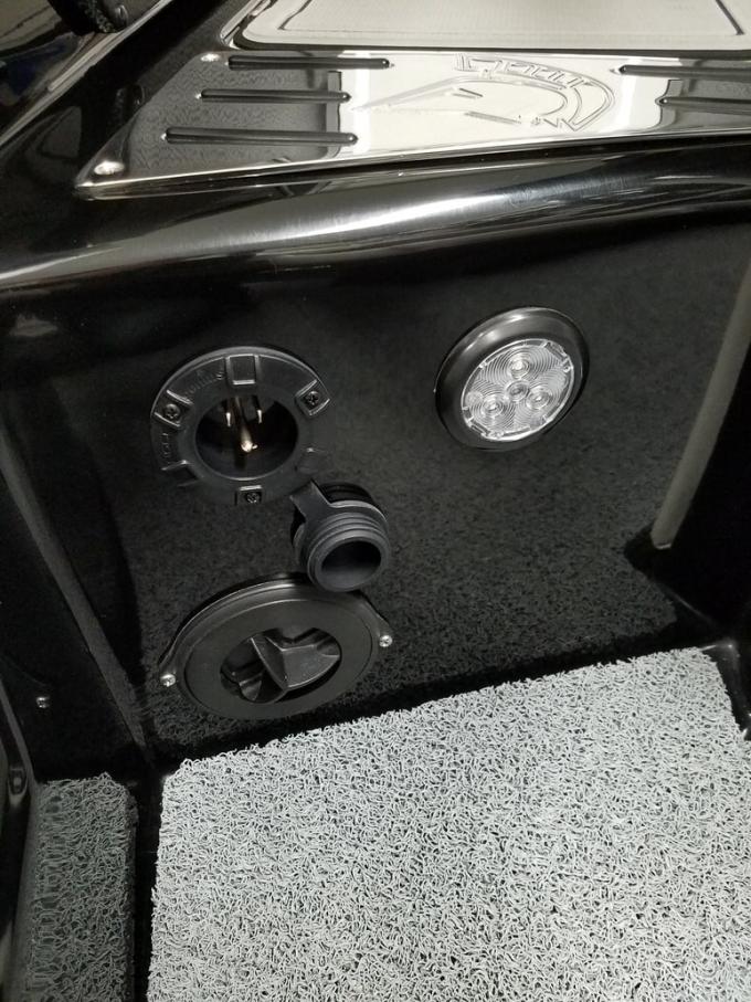

      I had a 3-bank NOCO charger installed in early 2018 (MLA installed this setup for me actually).... I had the 16" extension plug mounted into the side of the built-in cooler (see pic). This placement has worked very well for my situation and not having to open the observers seat to plug in this charger (or the 3 separate ones I used to use) is very nice. I have garage and keep mine plugged in 24/7 when not on lake. I believe this is the reason my 2 original batteries are still going strong ....+ I check the water level and top off as needed with distilled water in Spring/Fall. I like that the NOCO chargers have lights on them which tell you the status of each battery when plugged in. Personally I always have my battery switch turned to off when charging. To me, this upgrade (or any battery maintainer) pays for itself over a couple years as it extends the usable battery life.

        I like your placement of the NOCO changer and I plan to install my NOCO 2 bank charger there as well. Unfortunately on a G23 the batteries are located midship in the middle of the floor near the ballast pumps therefore I purchased another 10 ft marine 14 gauge wiring for each battery bank to get the cables back to the batteries. The NOCO battery bank only comes standard with a 5-6 ft run of wiring. I plan on placing my charging plug under the observer seat along the fiberglass area so like you I don't need to open the observer seat to charge the batteries.

            Id rather extend the AC with an extension cable, then extend the DC charge outputs. The factory location on a G is actually a pretty decent spot, and the NOCO cables will reach the batteries.
            Mounting by the amps on a G23, that extra 10's is going to be dang close to reaching the batteries.

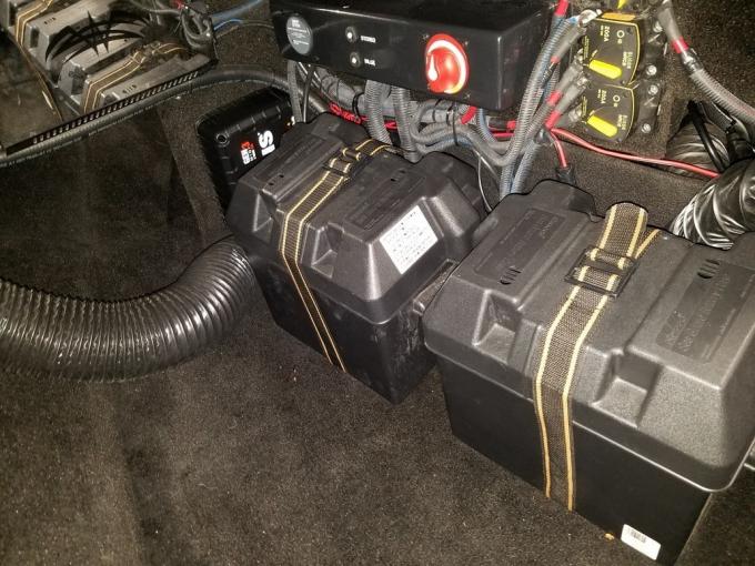

              Without extending the cables on the NOCO charger, were did you mount your charger on your G? The area under the obsearver seat is quite a far reach to the batteries, even though that is were I want to mount my charger.

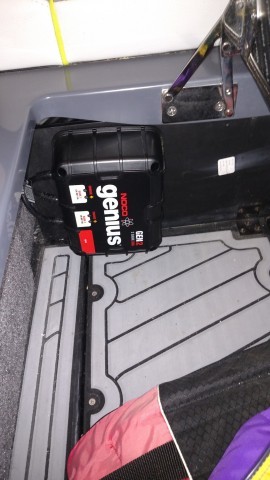

                #22
                As stated above, the factory location.
                  Click image for larger version  Name:	thumb_1019_640_480_0_0_auto.jpg Views:	0 Size:	35.9 KB ID:	599453
                  Not a bad location . From there the standard cables of 5 - 6 ft should reach the batteries. I may have to reconsider my battery bank placement . Thanks for posting picture
