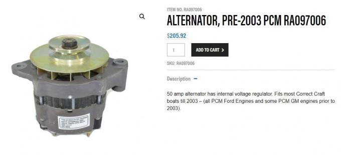

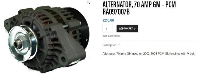

I was looking at the alternator last night, and I can't find any markings on it that might give me a clue what model it is. However, I hopped on NautiqueParts and thanks to their good photos, it sure looks like the marina put on the 70 AMP GM Alternator (pictured) which would be incorrect. I think I need to either order the Alternator, Pre 2003 PCM, or do the 100amp upgrade. Both photos are attached.
Does this seem like an accurate diagnosis of the problem? I'm also suspecting I need a new starter, but not sure if that would be connected to this problem or a separate issue.
