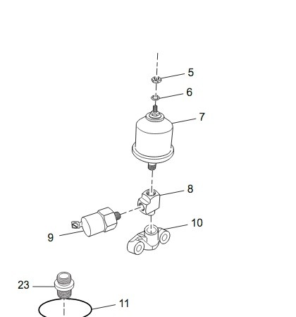

So trying to diagnois the problem of my oil psi gauge and the readout in the tack the digital readout if I take a test lead and ground out the wire on #9 nothing happens to the gauge or readout but if i ground out #7 the gauge pegs and the readout shows 80 psi.
Am I correct to assume both units run of the oil sensor (7), not the switch (#9)
Maybe should get both cause it is **** to get at.
Yes, both will read off of the sensor (7), not the switch (9). The switch would only be used to activate the check engine light.
I wouldn't bother replacing both. Just replace the sensor and you should be all set.Please do not PM me directly asking for advice on how to repair your boat. While I would love to help everyone, I simply do not have time to respond to all of the inquiries. Please post your questions on the forum, so that all of our members have a chance to answer.
