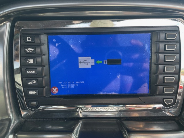

              #36
              Anyone have experience with this problem? Started up the linc and was greeted to this screen after the Booting…. It appears to be the boat loader update screen. I found a Murphy guide that shows the blue screen as the boot loader update screen and the black screen as the firmware update screen. I can not seem to get out of this screen. My assumption is that the linc lost / corrupted its boot loader. Anywhere to get the software to reload or any other suggestions?

                #37
                wish i could ,,your dealer should be able to help and send any updates free of charge...White Lake does....
