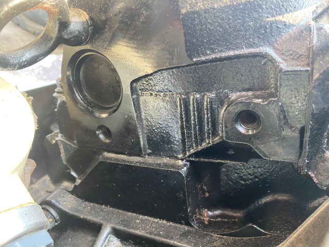

Hi, I got a similar question. I bought a Ski Nautique from 1991, but I can't find the serial number on the engine. A former owner changed the intake due to the LPG-installation.
I know it's not a GT-40 engine. But don't know if it is the normal engine (240 HP) or the HO-engine (285 HP)
The HO engine will have GT-40 heads. You can tell by looking at the side of the heads and searching for three bars.
