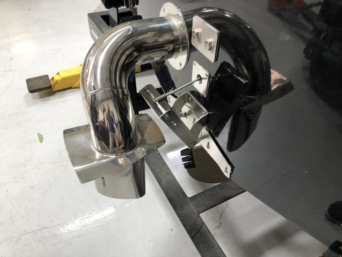

It doesn't look like much, but it changes the attitude of the boat...bow up vs bow down to affect the wake. With the bow up, you will have a steeper, but shorter surfable wake. With the bow down, the wake is less pronounced, not as steep, but you may be able to surf farther back on the wake. We find that where we need the lever varies with the water depth and amount of ballast and who is surfing...Play around with it while underway and you will see.
That's the hydro-gate, used to control the flow of water out of the dispersion tunnel in the hull. The important part is the part that moves vertically, not the part with the cable hooked to it. I would not disconnect or remove that.Please do not PM me directly asking for advice on how to repair your boat. While I would love to help everyone, I simply do not have time to respond to all of the inquiries. Please post your questions on the forum, so that all of our members have a chance to answer.

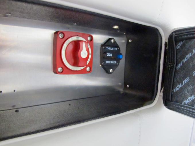

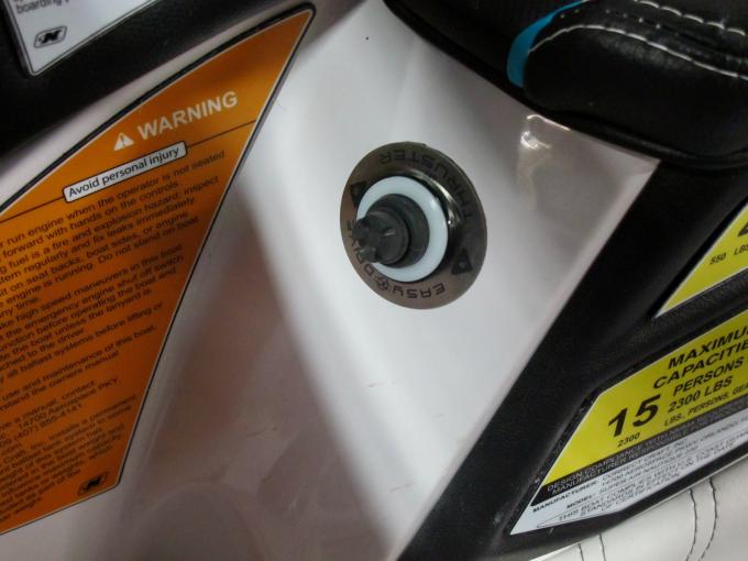

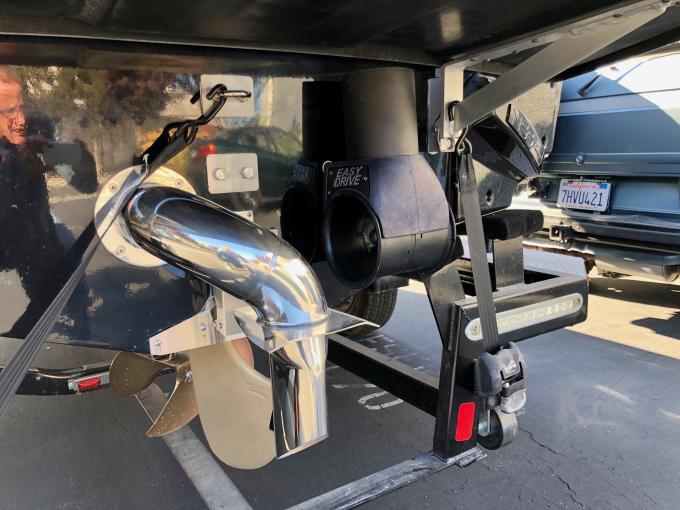

I don't have one handy, but we will be on the boat this weekend and will take a couple shots to post. It looks factory and totally sanitary. The parts cost $3500 and I did the work myself. It took about 10 hours. I should caveat this by saying I have a 12,000 sqft workshop, have built many airplanes, boats, and cars from scratch and have every tool known to man from large CNC mills to cranes that can lift the boat. The most challenging aspect of the install was wiring it so that nothing was visible, and it was thoughtfully laid out. I built an access panel into the trash door in the walkway and installed a similar battery cutoff and circuit breaker as exists for the normal battery control so it is possible to completely isolate the system. I'm not trying to suggest it is hard: the kit is complete, and someone with average mechanical skills can tackle this no problem. We chose to machine a few parts to clean up the install but you absolutely do not need to for a functional install.
Man that is cool seeing that on a 230. So the subtle hydrogate has a big impact on the boat's attitude. I'm seeing that big thruster right there next to it. Did you notice any difference in the ride while underway? By the way that looks like the Delta, and if it is, that thruster is probably really handy in those channels.
I was really worried there would be a difference in handling or the wake, but the thruster is above the bottom of the hull and does not seem to have any noticeable effect. It is the Delta, and it makes a huge difference!
