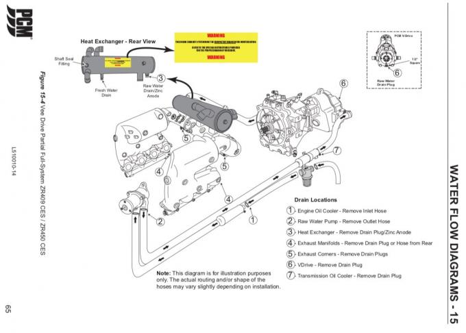

I suspect this is a total rookie question, but I have never had the "Freshwater Flush System" in a boat before. I am on the water year round and the boat is out of the water when not in use during the week. It gets cold here... in the teens. So, the questions:
1. To drain the engine of water (no heater or shower) is there an easy way with one plug?
2. Can I drain the engine via the Freshwater Flush System?
3. Do I need to run RV antifreeze every time I take it out of the water if 90% of the water is drained?
4. A shop said that some people use a heated oil dipstick to keep the engine oil warm, and it keeps any water from freezing.
Thanks for the help. I know keeping it in a heated garage would be ideal...just may not be an option at the moment.
