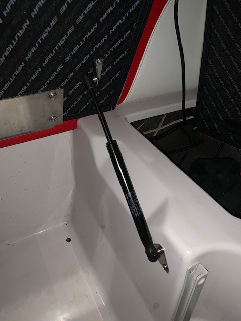

                              Thanks again IndyGreen! Just mounted mine today, pretty straightforward. It holds it up just fine and actually does provide a slight assistance going up. I tried to upload a short video sent from my Iphone but I guess it's too big a file...

                                Looks great! Finally ordered my brackets today so will be doing this very soon.
