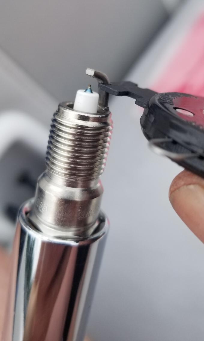

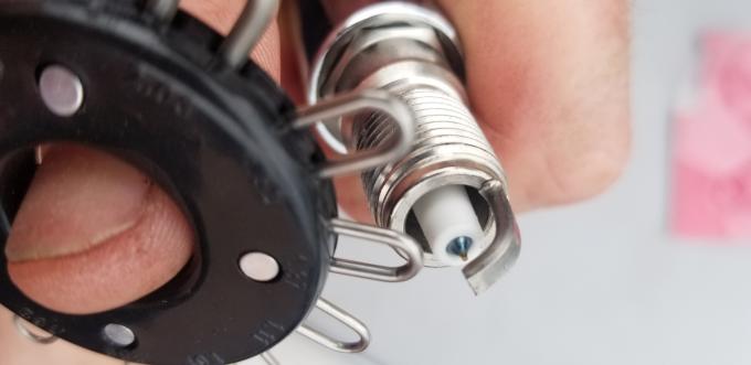

2. The previous owner or his mechanic didn't gap the 41-110 plugs. they were set to the factory .040. I reset them to approx. .060.(I say approx. because I didn't want to mess with them too much...It was larger then .054 and smidge smaller than .060. Iridium plugs can be gapped if you avoid touching the iridium tip. (See pic below). When measuring, don't push or pressure the measurement part in there...it either fits without resistance or its too tight.

Pics of gapping/measurement tool
