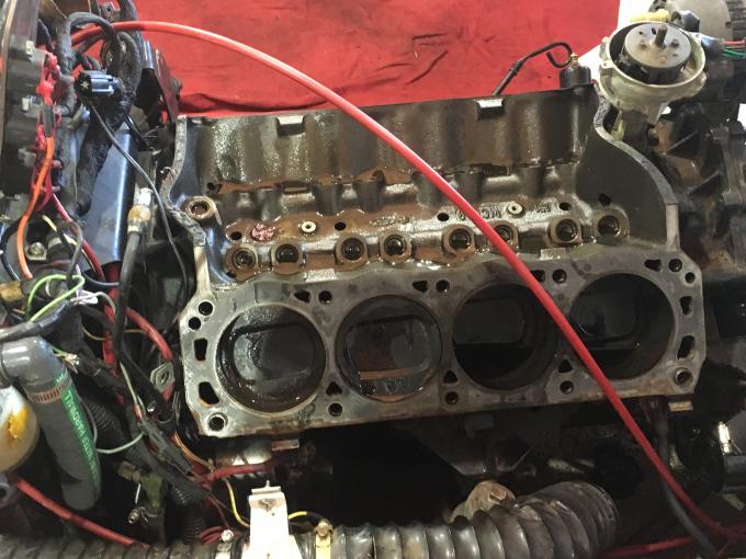

                            • MDRichmond
                              • Jun 2019
                              • 67
                              • Lookout Mtn GA
                              • 1995 Ski Nautique Open Bow 2002 SAN TE
                              Update: At a new mechanic and I've got a blown head gasket and a cracked head on one side....We're looking for a new head and they're apparently difficult to find. Anybody know of someone selling a GT-40 head that would fit a 1995 PCM 5.8 HO ford block?
