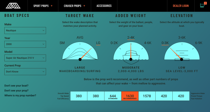

            Swatguy, I get what you're saying re RPMs. I run around 24ish MPH for wakeboarding, and really never exceed that, so RPM increase shouldn't be a big deal right?
            Also, everyone please see the attached pic. This is from Acme's site. I plugged in all the relevant info - Year, Make/Model, etc of my boat and then for "Wake" chose Large, for "LBS" I chose 2-4k lbs (I can't see myself hardly ever approaching or even exceeding 4k lbs by much if at all) and for elevation I chose the lowest - I'm in South Carolina.
            So, it tells me the best prop is 1630. This is a bit different than the props others have suggested on here. I'm actually not seeing ones you guys suggested.
            Thoughts? Just go with the 1630?

              #21
              Acme is always in search of getting he most performance out of props for each specific boat . Over the years they have fine tuned certain props to match specific engine combos /boats better. The 1630 has the same dimensions as the 1578 just a different cup to it. It has more
              cup , More cup equals more bite , which equals , less slip , which ultimately lowers rpms a touch . A very minor tweak which probably happened over the years due to feed back and research off the 1578 after being around for a bit. I’d trust their prop tool for sure as it probably has the latest advancements in prop tech built in. So while it doesn’t match a lot of the advice here of the 1578 , the guys with the 1578’s have had a them a while and the 1630 wasn’t even built back then. So I bet if the guys with the 1578’s now wanted to replace that, Acme would probably steer them to the 1630 . Just an educated guess as I myself didn’t know the 1630 was the go to these days , but reading the specs on it I can see why that would be the go to . All the benefits of the 1578 with even more bite and a lower rpm range .

                #22
                For your application I think you would be very happy with either the 1630 or the 1578.

                  #23
                  Thanks for the feedback. Seems like I'll be ordering the 1630. However, before I pull the trigger, is there any reason you can think of for going with the 1578 over the 1630?

                    #24
                    Like Swatguy said, maybe a little lower rpm and more speed up top, but I doubt you could tell a lot of difference. The 1578 is a proven prop for what you do and a lot of guys like it. The 1630 is just tweaked down a little bit.

                      #25
                      You could probably find 1578 used which would save you cash, but if you’re going new for new go with acme’s recommendation

                        #26
                        So, after speaking with ACME they actually suggested buying the 2570, which I did. NIGHT AND DAY DIFFERENCE! The boat holds speed better but especially planes off much much faster. It does seem though that the size of the wake, with the new bigger prop, is a little bit smaller. Maybe it's just all in my head and everything is the same except what I stated about holding speed and planing off better. Has anyone experienced a smaller wake in changing props?
