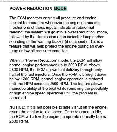

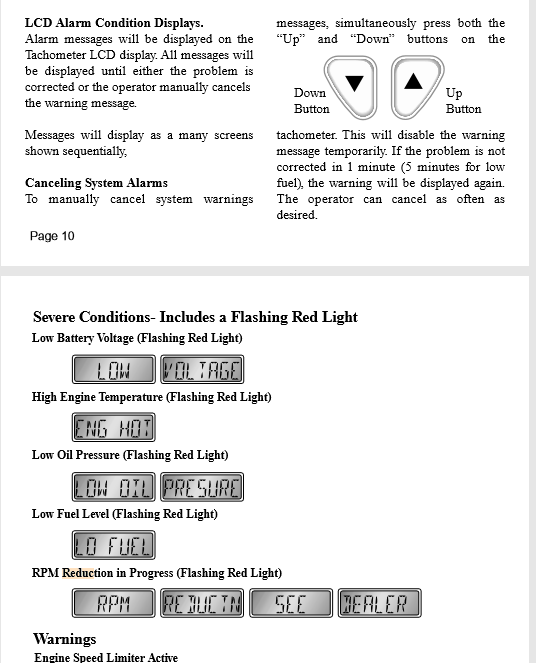

            I believe he meant to type RPM for the message. I found the following information in the 03 216 manual, PCM manual, and PCM parts manual for the same year in the Manuals/brochures link near the top of the forums page.
            It sounds like the boat is going into Power reduction mode.
            Is there only one message showing on the display? If your engine temp and oil pressure are showing good on the gauges you may have a bad oil pressure switch or temp switch. These do not run the gauge but tell the computer if the temp or pressure is bad. There are many posts about this.
