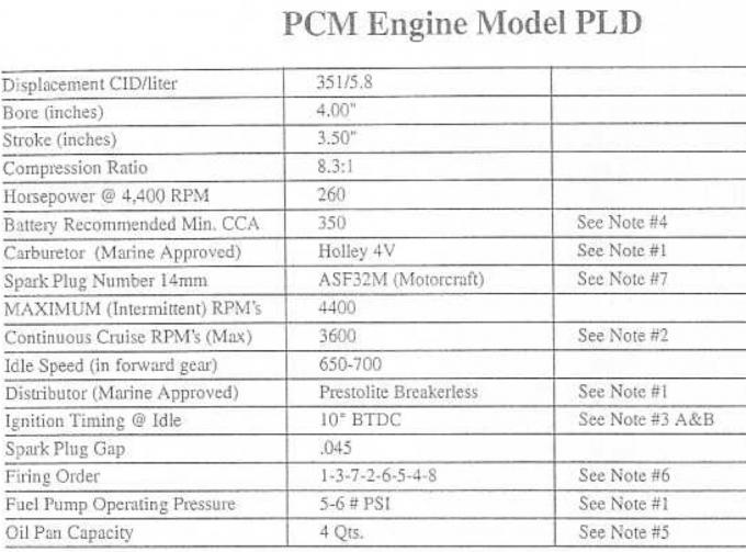

Have two PCM 5.8 Ford Windsor’s in my boat and I have been struggling to find the total advance timing and what rpm its at. They are 1999’s and 260hp models with prestolite electronic distributors. Any help would be appreciated .
How did you determine that? I have always wondered with the high-speed advance should be on these engines. Is this just from setting the idle advance and checking it at high-speed to see what you've got?Please do not PM me directly asking for advice on how to repair your boat. While I would love to help everyone, I simply do not have time to respond to all of the inquiries. Please post your questions on the forum, so that all of our members have a chance to answer.
Yes
here is a base line that was posted on CCF
Edit : may be different just noticed the OP has an electronic distributor but should be similarSpeaking of numbers, for whoever cares, here's what I came up with for the PCM heavy spring and a Hillman #119 installed in a clip down cap distributor.
