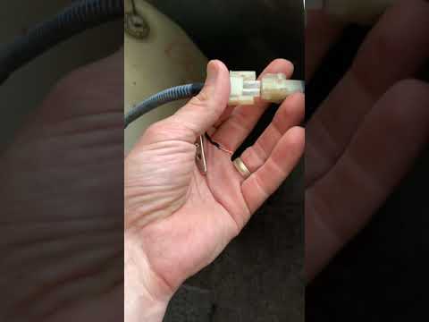

      lastly, check this video I made.

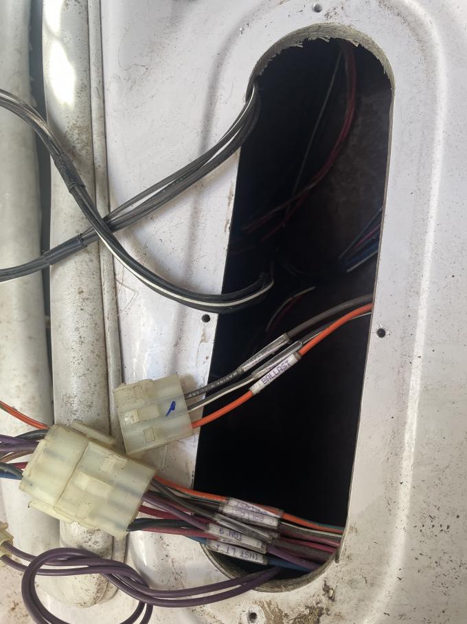

          2007 SV211- My ballast gauges light up but always read empty, the pumps all work to fill and drain by manually pushing the buttons. I pulled the cover plate to look for a loose connection and everything looks god except the plug with three wires (labeled port, starboard, belly)… I can not find where this should be plugged into… does anyone know where this should go? Thanks Click image for larger version

            jstallings Do you have the stock hard tanks in the boat?
            • jstallings
              • Oct 2009
              • 15
              Yes everything is 100% original, I bought boat new in 2007

                If you don't get it resolved, I can pull my gauge panel and check it for you, but it won't be for about a week or so. I've replaced my rear tanks with bags, but the gauges worked before that, and I left the belly tank alone, and that gauge works (well, it works as well as those gauges work).

                  Thanks if you don’t mind taking a look I would appreciate it, the gauges haven’t worked for a while (light up at night though) and everything else works. I just thought I would check for a loose connection, and then found this unplugged wire with no where to go.

                    Yeah, it doesn't seem like that plug could work its way loose on its own.

                      What happens if you unplug the wire at one of the tanks (there should be a connector near the tank), and run a jumper wire that creates a loop back on the side that goes back to the gauge. If the wiring is hooked up, the gauge should go to F instantly.

                        Thanks! Good idea I will give that a try. - still odd that three wire plug is not connected to anything though...

                          I agree with you on that. It's really weird. One possible explanation would be if that same harness was used on different boat models and yours didn't need that wire.
