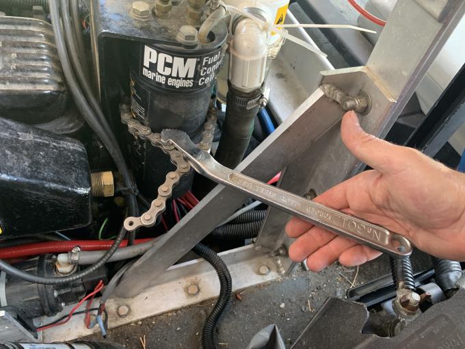

I have ripped the handles off of two oil filter wrenches using cheater bars trying to unscrew this thing. Any tips?

Some people remove the whole assembly and put it in a vice in order to get the bowl off. They were notoriously tight from the factory. Has yours ever been opened before?Please do not PM me directly asking for advice on how to repair your boat. While I would love to help everyone, I simply do not have time to respond to all of the inquiries. Please post your questions on the forum, so that all of our members have a chance to answer.
Thanks for the reply. It I've owned it since 2011 and I have never opened it... not sure before that. A vice sounds scary... how beefy is the metal? Is that aluminum? Can I put a giant pipe wrench on it or will I crush it?

The filter housing is pretty beefy. You'd have to really be cranking on it to crush it.

Thanks a ton for your help on the other thread. Where were you $400 ago?As for this one, new filter is on the way anyway... it's been 19 years, maybe it's worth changing it out anyway. ha. And I can't give up at this point... gotta get that thing off. I'm borrowing a beefy chain style strap wrench tomorrow. I'll give that a go before I pull it all the way out.
Can I just hand tighten that thing back on like I would an oil filter, or do I need to apply 647 foot-pounds of torque? haha.... why so tight? It's an O-ring and not relying on the threads for a seal, right?
No need to crank it back down. Just hand-tight, and make sure it isn't leaking.Please do not PM me directly asking for advice on how to repair your boat. While I would love to help everyone, I simply do not have time to respond to all of the inquiries. Please post your questions on the forum, so that all of our members have a chance to answer.
