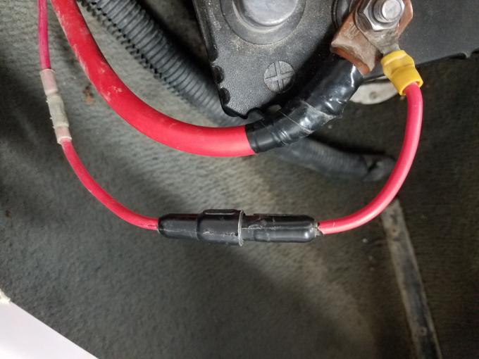

          Maybe you've seen this thread, but this guy had luck with something as simple as replacing the inline fuse on the positive cable located near the battery. Sounds like it doesn't have to be completely blown to cause issues. For a buck it might be worth a shot.

            I saw that post and checked to see if my boat has one, and it doesnt, that i know of. Its not in or around the battery box at least. Thanks for your response.

ID:	588399 Ok, so you don't have a wire like this coming off your battery?

                No i sure dont. Should I?
