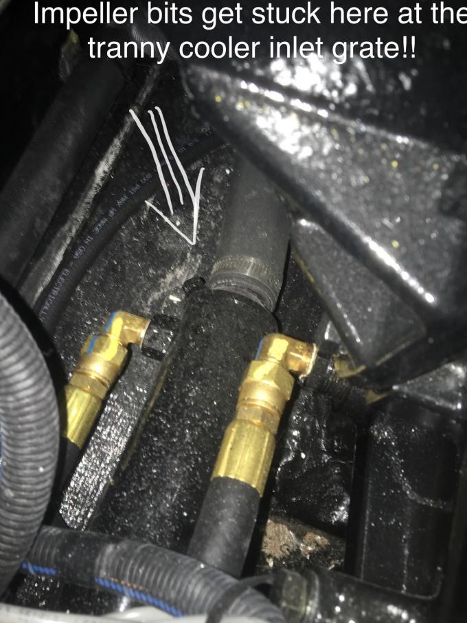

            Impeller bits DONT make it to the thermostat. They get stuck at the first stop after the water pump: tranny cooler intake grate... and clog the water flow to the entire engine.
            start at the water pump and trace the hose down under the engine. Remove the clamp and find your impeller bits.
