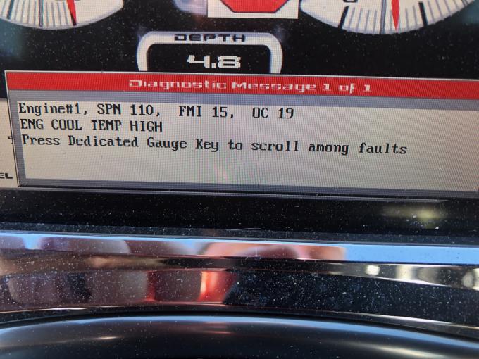

    Has anyone had the error pictured come up? I assume maybe impeller or thermostat or something?

    Likely culprits:
    - Impeller
    - Clogged raw water strainer
