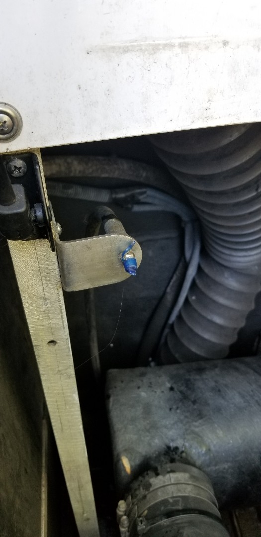

    What is this?
    What is this? Its in my engine compartment.

    Standard Grease fitting that leads down to your rudder swivel or bearing. Standard Zerk fitting for a regular grease gun.
    your supposed to add a couple pumps of grease every year to keep it moving else it will harden in that tube and get constipated

      Thank you sir. Grease gun is now on the list for my next trip to the boat.

        What NyRyan said... Exactly
