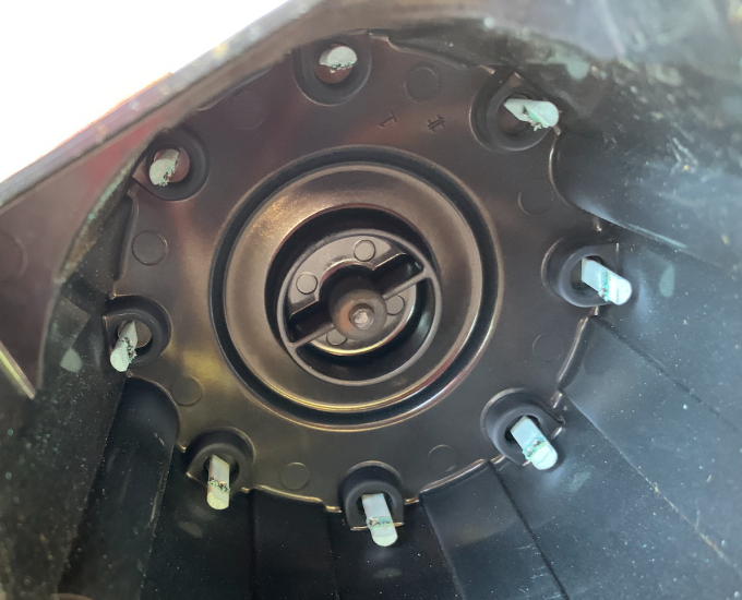

                Distributor cap had some definite corrosion going on...
                Click image for larger version  Name:	Screen Shot 2019-08-16 at 4.09.56 PM.png Views:	0 Size:	536.9 KB ID:	591843

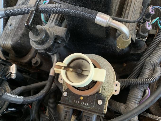

                You can see a bit of crust/corrosion at every terminal. Matching gunk on the rotor, and on the distributor cap mounting plate:
                Click image for larger version  Name:	IMG_2304.jpg Views:	0 Size:	65.0 KB ID:	591844

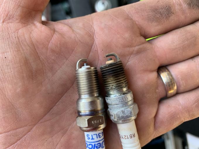

                I hit it all with electrical contact cleaner and wire brushed/blew off all the crud that I could before sticking the new cap and rotor on there. The plugs didn't look alarmingly bad... they were all about the same with no one plug showing any signs of one cylinder running too rich or too lean. About normal for 19 year old spark plugs:
